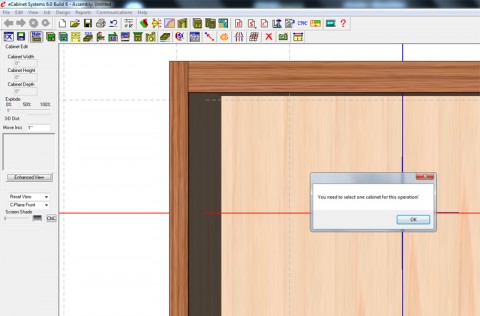

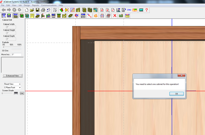

Here is a screenshot when I open an upper cabinet I had created earlier (created either from an existing cabinet I created previously or one from the standard cabinets folder) - the shot shows the greyed out dimensions and what happens when I select construction settings
Also attached is the hsf file
