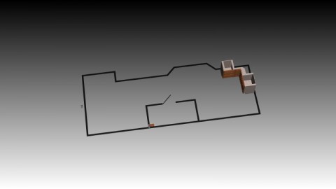

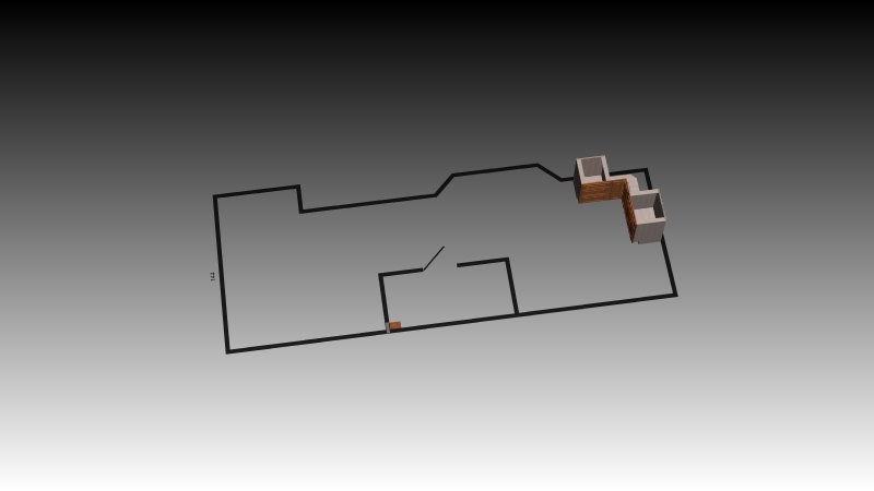

My work around for that is I would trun your DWG or floor plan in to a STL.
Open your custom layout I put one wall in the layout at_0,0 Then put the STL in the layout.
