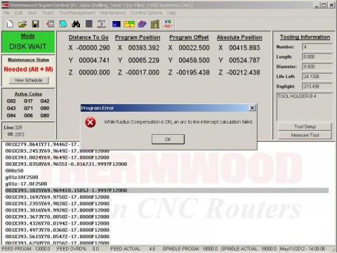

Hello all
we are doing this job and facing this issue error screen shot isattached and the machine stalls then have to estop to home and have got few more same codes on the same program whaich are same issue too (program attached )
and pocket is not being cleaned there are steps leftover and manchine has finished cleanup but the stepsn are still there
job is stuck halfway on the machine and have to finish it before taking it out please if some one can help me it will save us down time
Mohan

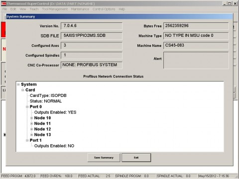

Mohan, it looks like a Thermwood Software update may fix this problem, to be sure we need to run your program with your current version of software. Can you verify your version of Thermwood Control Software on your router..We will run with your current version and see if we get the same error as you and then we will run with the latest build of THM software to see if the error goes away...

Hello Joe Harger
i have sent you an email(Tue 5/15/2012 7:18 AM) with the machine info screen shot have you not received it yet ,
any way to clear all issues i have uploaded here in the forum
please let me know if you need any more info to troubleshoot the issue
Mohan

We've been getting this error for 6 years now. Our previous work around was to have the cad dept redraw the part. This often did not fix the problem and wasted a lot of time.
Recently we discovered that there was a discrepancy in the code. The line that was highlighted when the error appeared was different than the following line. For instance, the highlighted line would read x49.1234 and the next line would read x49.1235. This was usually on rectangular parts with radius corners.
It turns out that our dxf file reads 8 or 9 decimal places and the CN rounds this down to 4 decimal places. Depending on the axis and the direction on that axis, it sometimes gets rounded up, sometimes rounded down.
Our current fix is to change the next line to read the same as the highlighted line using TAB, and hit START. This works 99% of the time.

Sorry,
If you look at your screen shot, your Y axis program position is 65.229. Your distance to go is 4.741. This adds up to 69.97, not the 69.9694 that your current line reads. On a rectangular part we would edit the next line to read 69.9694. Not sure what your part looks like. Also not sure if you can edit the CURRENT line to read the 69.97 that the router wants to go to.
