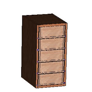

Can anyone tell me what the slot slide settings are for in the global settings ?

Hey Mike, it allows you to design a drawer box where the bottom is extended into dados in the cabinet, and used in place of slides.
BOD Bottom Slides.jpg (11.7 KiB) Viewed 15197 times

That's interesting Rick. I never thought there was a demand for such of feature : :o Thank you for figuring that out!

This is a part of the youbuildit furniture construction.

The Help document in eCabinets has both a What's New" section and a search of slot will take you to additional descriptiosn and procedures.
