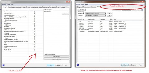

I have an other question regarding this. I have created a lot a slide in a new categorie. When I go into the door / drawer editor nothing appear. The only place I get add an hardware is in the main view in the right panel window, cabinet buy list. Is there any possibility to have acces to it in the door / drawer editor?

With regards to your drawer slides. There is a category for slides, so that is where you would need to place them. As you've found, if you put them in a category of your choosing, then you have to add those manually. If you add them to the Slide category, then the software automatically adds them to the buy list in the required quantities. So in this case, whenever possibly, use the categories that are available.

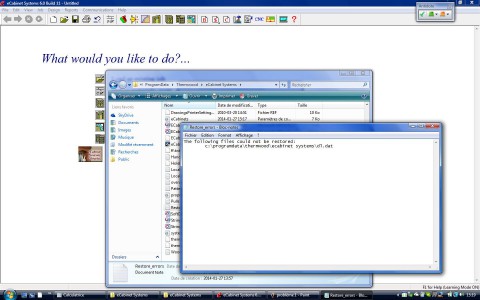

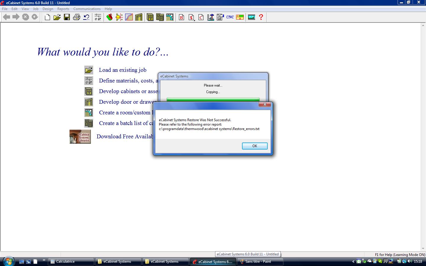

I tried the backup thing but when I transferred it to the other computer I get this: see picture attached. I try many time but always get the same thing. Does someone know how to solve this problem?
