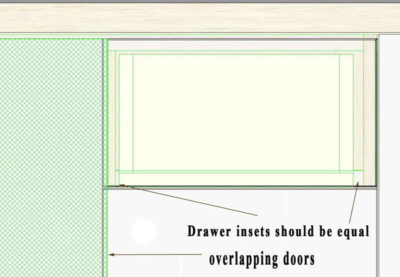

Re: Conestoga doors ignore partition and doors overlap
Hi Forrest
I was going to report this one as well.
I had the same thing happen with slab doors.
All seems good untill you leave the door and drawer editor.
I found the drawer box lost its side insets on the partition side as well, I think it was working off the center of the partition rather than from the face.
I was in a hurry at the time so we just left it and did it another way.
