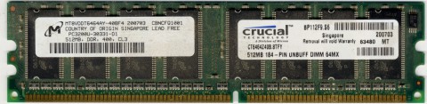

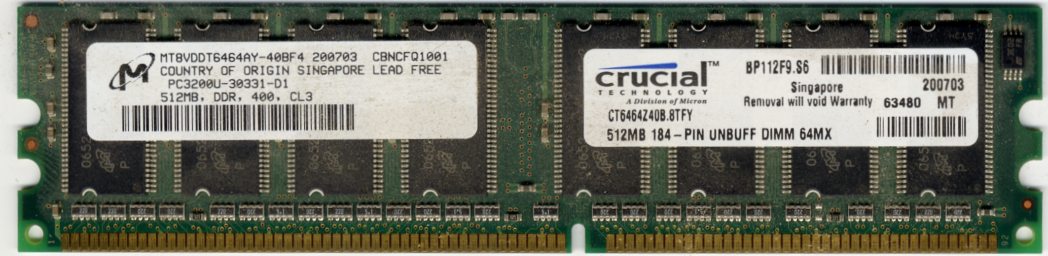

The best thing to do if possible is to remove the memory in the machine and insure you get the same configuration for the upgrade. That being said I have a 2007 CS 45 and have taken a photo of the ram configuration info. I will attempt to attach it to this post. As Will has stated with XP 4 gig is the most the system will use.

Hi Gerry
That is the same as my original ram. with the upgrade I have pushed programs through with 4 to 5 million lines of code.
I called thermwood tech support for the info.
One other thing xp will reserve a certain portion of your ram for virtual memory and will not let you use it. I'm not sure of the procedure but Kipp made a change so that I could access almost the whole 4 gig.

Postby Gerry A Brown » Sat, May 02 2015, 2:01PM
Hi Will,
That is the memory module I took out when I upgraded the ram in out controller. I think it would be the same in a machine of the same year but it never hurts to check if you are going to order some. We also updated the hard drive. I remember something about the setting to allow XP to use all 4 gig of the memory but I have not done so on the controller. I agree updating the memory even without the tweak to use all of it was very worthwhile.

I have ordered 2 gigs of ram off of newegg (about $96 CAD) after removing the current module and photographing it to be sure I ordered the right type. I plan to upgrade the controller within the next year so this should hold me over and save me from those frustrating crashes for the time being. I'll update when I have installed the new ram.
