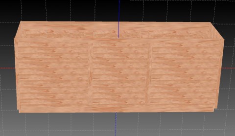

Here is a cabinet that I came up with based upon this thread as well as your previous thread. This is a single cabinet that uses the new feature opening locks and part associations. It is pretty much totally resizable with the exceptions of the toe kicks. If you need to change the toe kick height and or depth then you need to accommodate for that on the partitions in the constraint manager. As well as inset 3 in the stretcher editor for the toe kicks.
Sorry for the lack of details. But I will try to get a video together on this soon.
Hop this helps.
Scott Marshburn.

Looks good Scott,
The only thing I might have done has to do with my own preferences for construction. I would have made the mid style/mullions twice as wide as the outside stiles and I would have run them from top rail to bottom rail putting the drawer rails between them rather than running the drawer rail through. As for resizing, I trust you have that covered. :D

Oh, Wow! Nice. I am looking forward to that video.
I'm going to try and disassemble the thing and see what you did. I did some resizing and I did not see any problem with the toe/kick.
I use a detached toe/kick anyway so the non-resize of that is not a problem.
I agree with Ralph that I would keep the mid stiles the full distance between top and bottom rail. I use mid stiles at 1.375". My left and right end stiles are flush to the inside and have 3/4 scribe on the outside edges. This keeps me from having to block the slides. Also makes getting adjustible shelves in and out a lot easier.
I cannot say enough about the encouragement this gave me. Thanks again Scott!

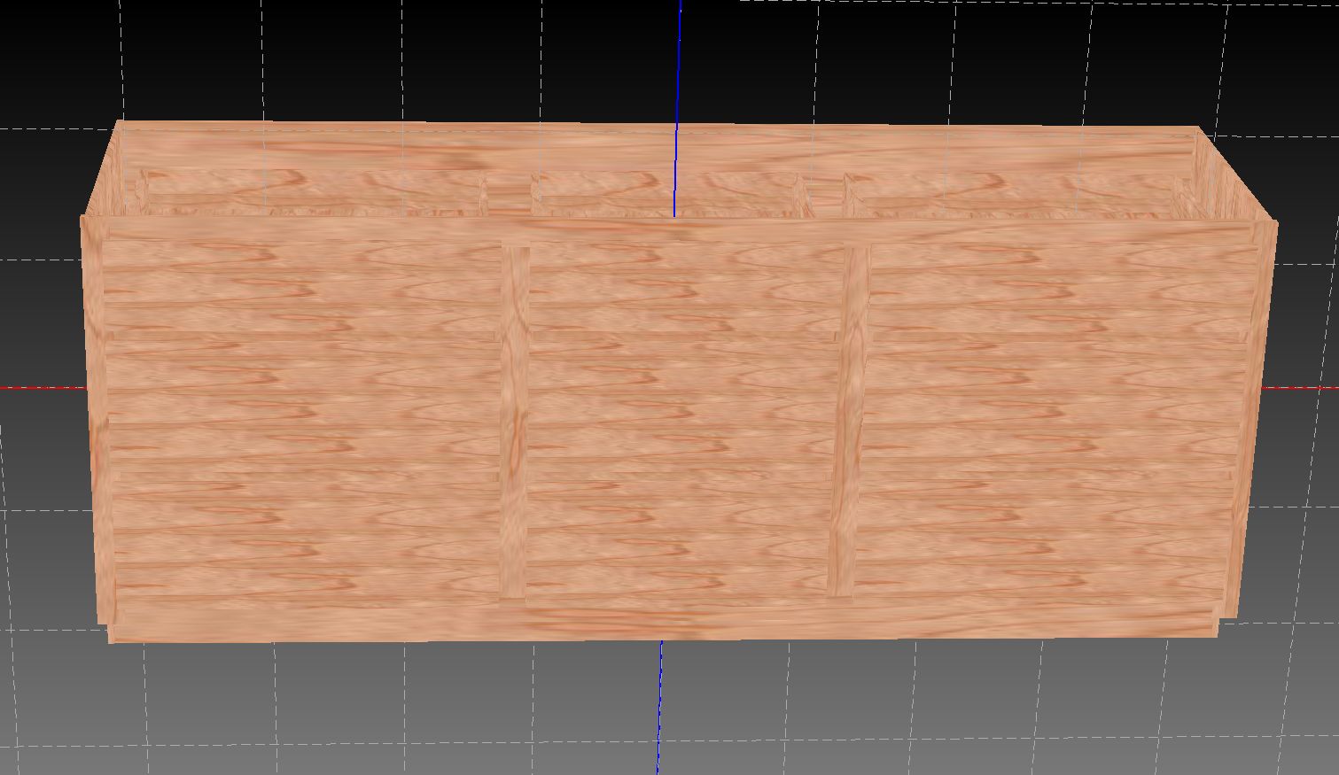

I was experimenting with it a little this morning. I found it quite easy to reconfigure the face frame as per your construction preferences. I also used a detached toe. I made the Toe kick stretchers phantom parts just in case I might want to use them in the future. I did have to remove the cutouts in the partitions. It did not like it when I tried to constrain the cuts to 0.
Scott Marshburn

Terry Hall wrote:Maybe I'm misunderstanding your meaning Scott, but I equalize and resize mine all the time using the construction method of running mid stiles to top and bottom rails, then adding mid rails. In my opinion the look is better and it makes for a more stable face frame. I have done it both ways over the years and it's personal preference I guess.
It might just be me but I cannot for the life of me get the openings to equalize. If I set the mid stiles to run from the top rail to the bottom rail with mid rails between them. For example a 60 inch cabinet with 2 inch stiles. If I make the center opening 36 inches with the left and right being 8 inches .Then select the three lower openings and try to equalize them. The result I get is nothing happens.

Good afternoon Scott,
I simply took the cabinet that you created, made the changes to the faceframe as per my preferences and changed the width of the cabinet. I made it six inches wider and it resized and equalized all the openings automatically and without issue. Perhaps something in the cabinets as you have created them might be running interference. You know -- gremlins :D
