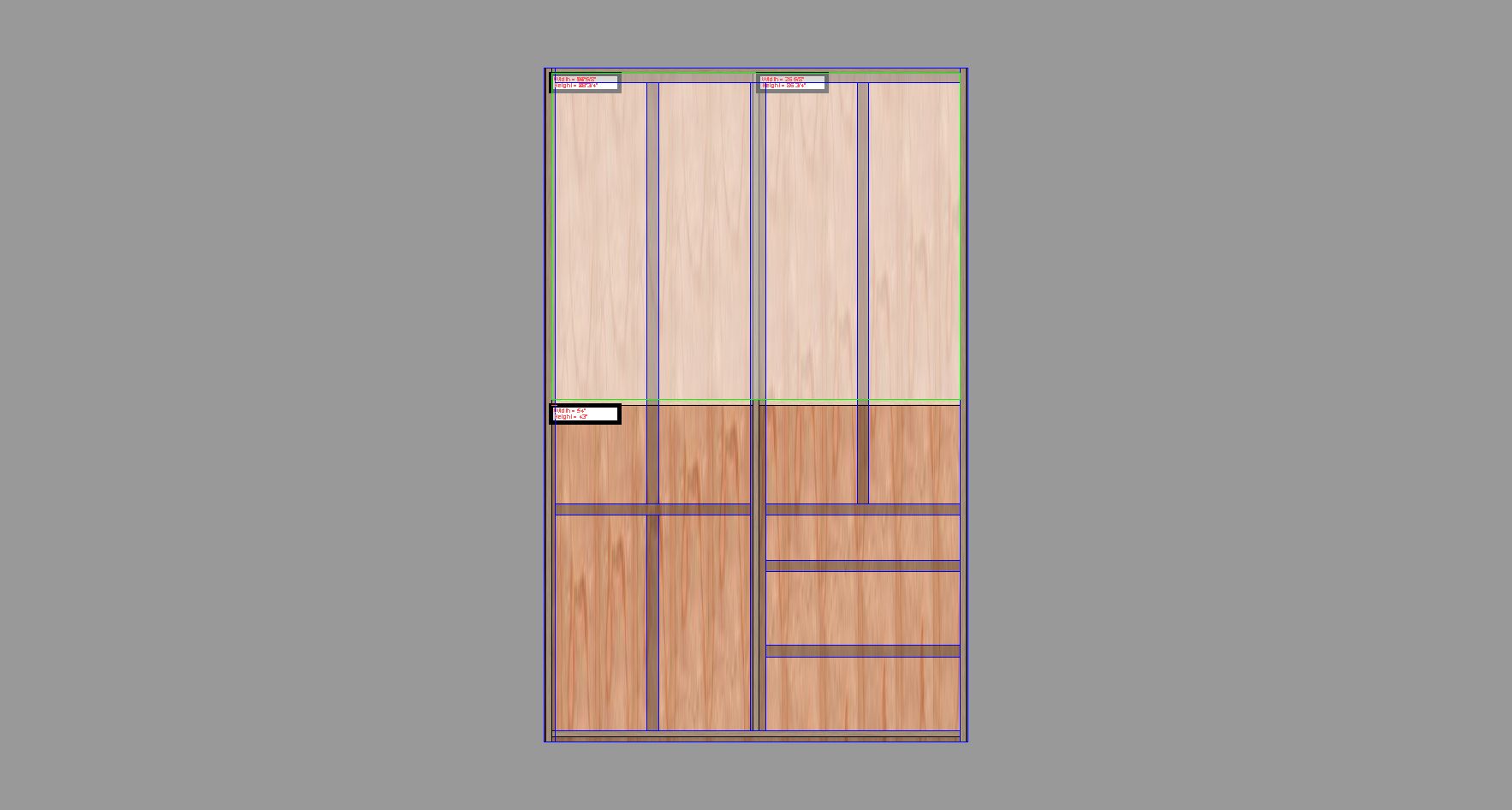

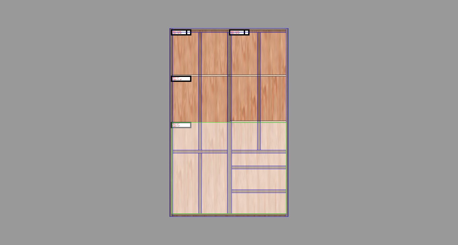

I have a wide, tall cabinet--56W X93H. I have put a partition down the center. then added a fixed shelf in one side. When I go to add another fixed shelf to the same side, it picks an opening the full width of the cab not just the one side . It ignores the partition and makes a full with shelf. I can not pick any single new opening I created. No associations, or locks. Also I when I try to pick a part/shelf to delete, it describes the part but picks the whole opening. If I zoom in real tight I can pick the need part.

Hi, Jon. am not sure what is going on. I downloaded the cabinet. I took it to the shelf/partition editor and got the same results. when I tried to select the partition it would not highlight. I had to use ctrl-A to get it selected. however, when I deleted it and added it back everything seemed to work as expected. ( I could select the left or right opening. So I added a fixed shelf to the left opening. now when I select the right opening with the cursor above the shelf, it selects the left and right opening above the shelf ignoring the partition. only now when I select the left opening it selects the entire left opening ignoring the shelf.
