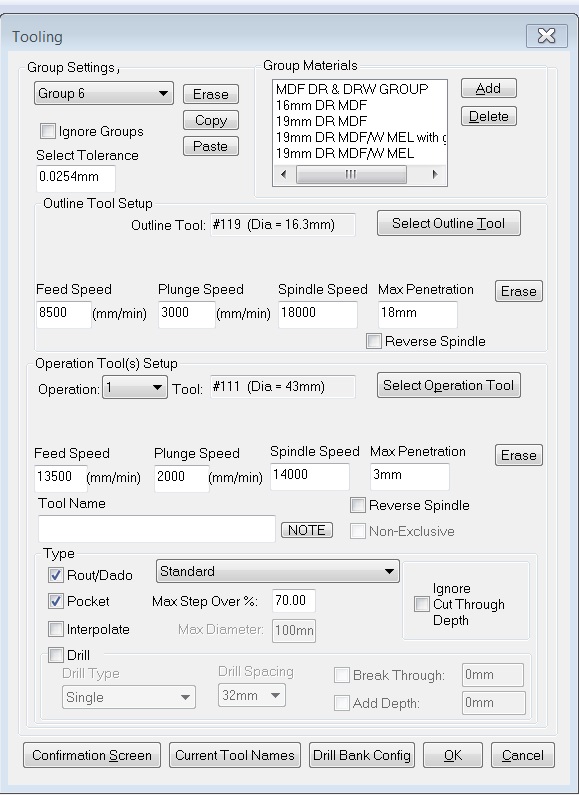

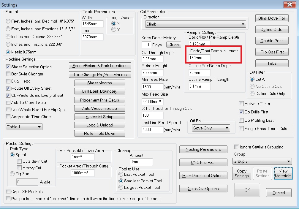

Tommy Wieler
Posts: 79
Re: Ramp for pockets
Postby Tommy Wieler » Wed, Jan 31 2018, 12:15PM
We also use a flycutter type tool for pocketing on mdf shaker style doors, and we were able to lengthen the tool's ramp-in length by changing the rout/dado length setting
Below are our tooling settings for the pocketing tool.
