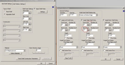

Better yet, look at the settings in this pic, notice we have all three colums checked to apply holes, on the right side I gave the back holes a negitive number (-3) so it would put the holes off the part and they would not show up. Set your cabinet to these settings and then take a look and see if that is what you are wanting.
