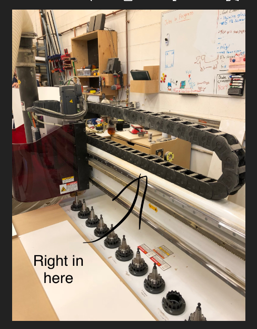

I also suggest visually checking all the wire. we were having the same issue but with out z axis going out of bounds in the middle of the table. and we had cracked/faulty wires

Thomas, thanks for the suggestion. In the picture, where did you take it? Are these wires in the spindle head or under the table?

here is the picture

Re: Y axis Out of bounds
Thomas, ours is older machine and not set like that but we do have a wire chase similar and we will check. However, Thermwood had me turn off tool comp and program runs like a dream, even though we ran it 4" above table. Not in wiring likely.

Looks like you have some talented whiteboard artists there, Thomas...
