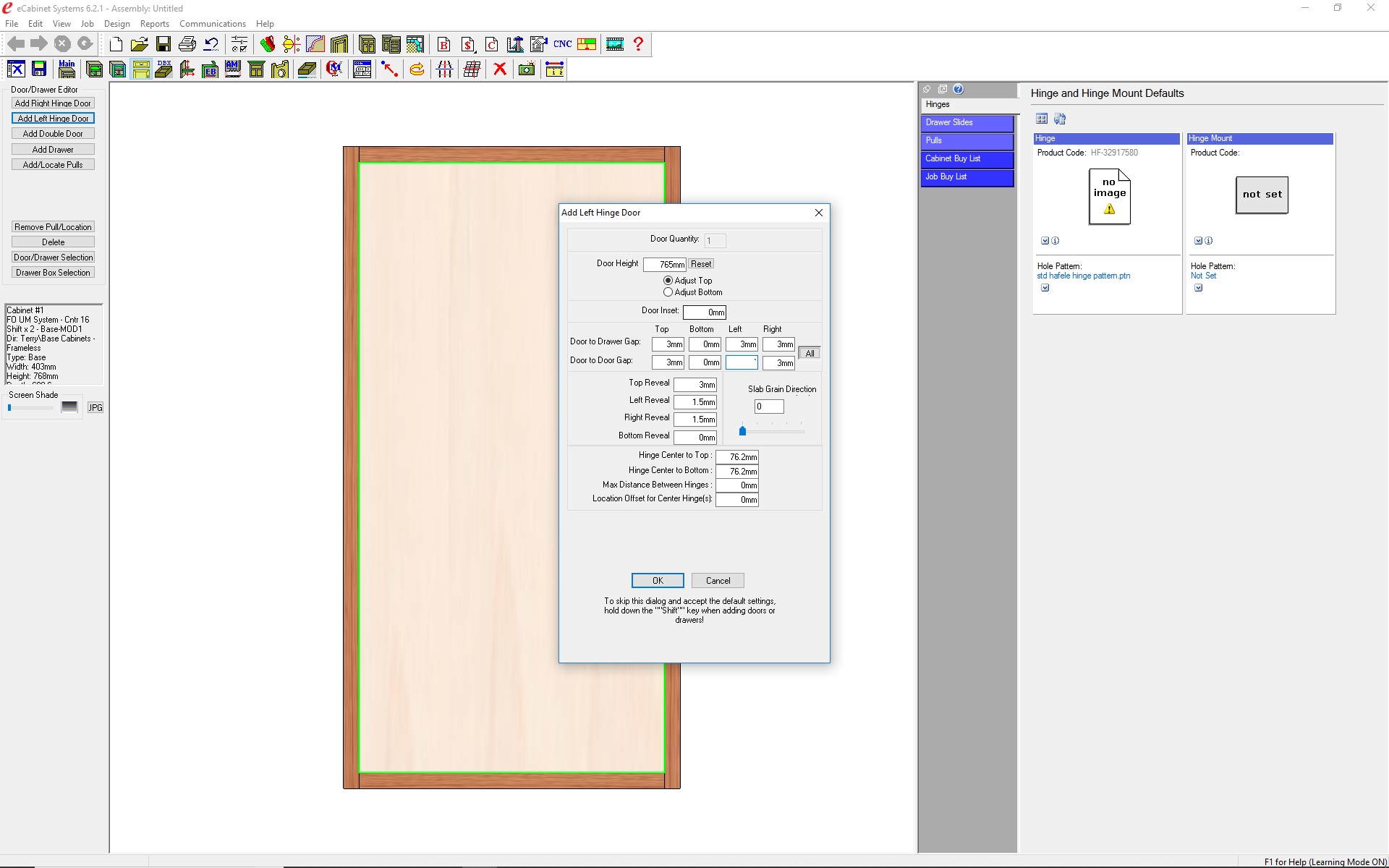

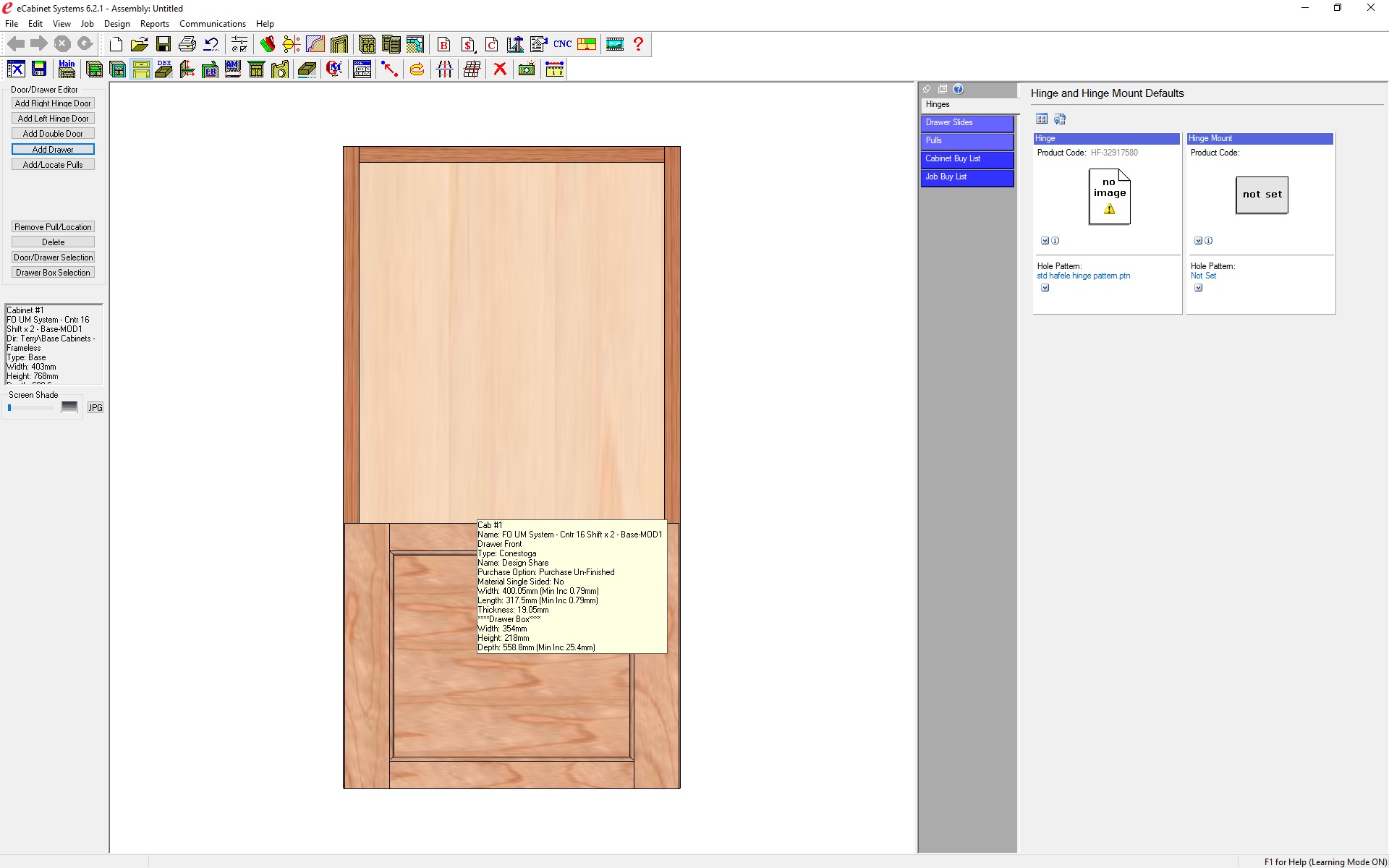

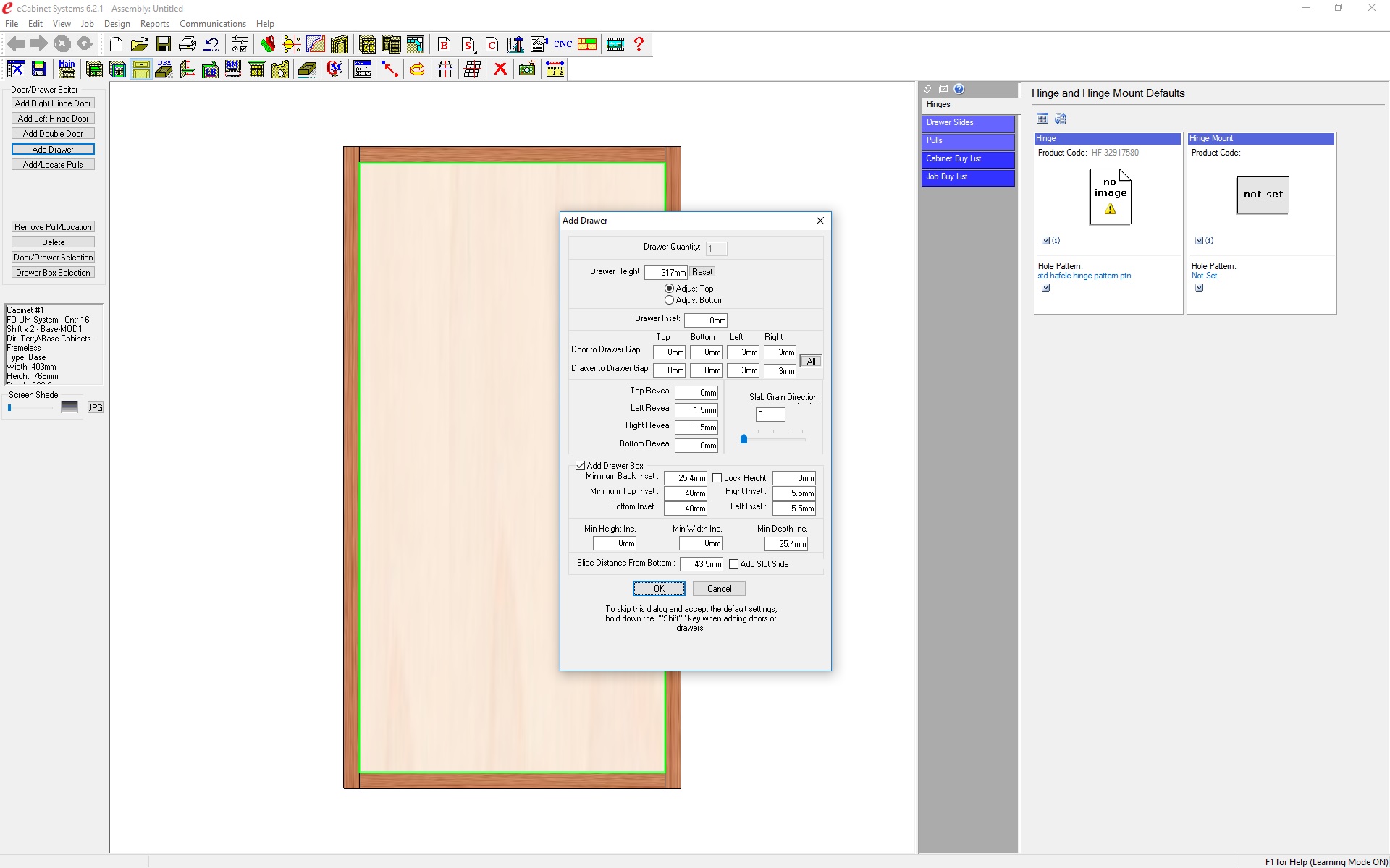

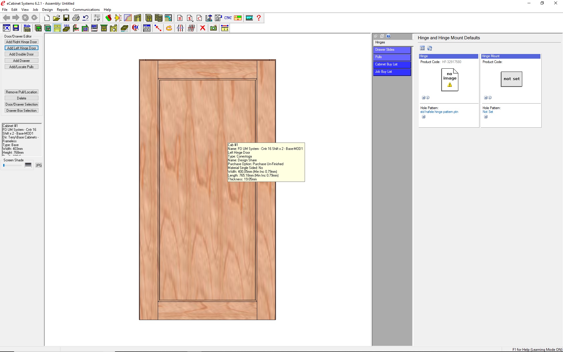

Ok, I figured it out. Here are both drawer and door installs. The door will allow me to achieve the 3mm top gap, drawers will not if I add all of them, but you can immediately see the sizes are different than what I've specified. This is a cabinet from the eCabinet library for download which I stripped down.

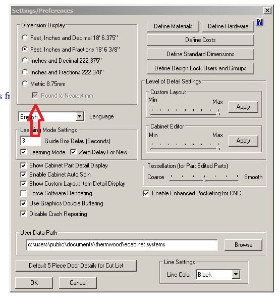

drawer width - you have a reveal of 1.5 mm reveal - that means take the cabinet side material thickness and subtract 1.5 mm and the drawer front will cover the rest.
Sorry but i dont use metric so i get a little lost but in your first post I think i may have a solution - look at this box
would that help??
www.TLCW.us
