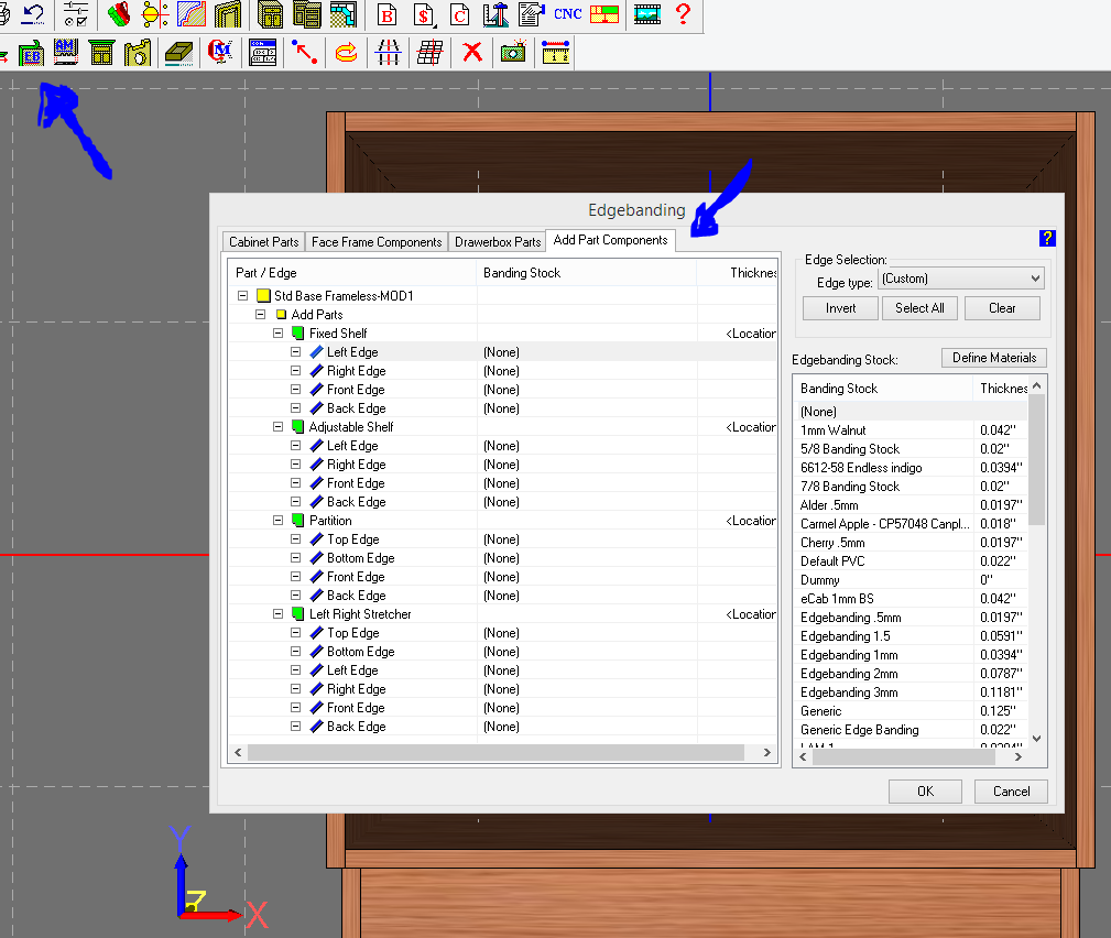

I'm building a new library of cabinets and any time I add an 'up-down/ stretcher', it automatically applies edgebanding to the top edge. Have I got a setting somewhere turned on for this that's causing it to do this? Thanks

Hi Nat, there is a setting for that. When you have your cabinet open in the Cabinet Editor, click the EB button, and then the "Add Part Components" tab. If your Up/Down Stretcher has an edgebanding set there, then every stretcher you add will have the banding on it.

Thanks Jeremy. For some reason I've never even seen that tab before...
