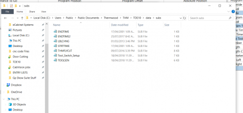

Thomas strembitsky
Posts: 274
Re: Desktop Software & Time Study
Postby Thomas strembitsky » Thu, Aug 15 2019, 2:06PM
you have to import your sub routines from the physical cnc. that the only way I got it to work cause for whatever reason thm desktop doesn't ship with them.
the file path is C:\Users\Public\Documents\Thermwood\THM\TDE10\data\subs

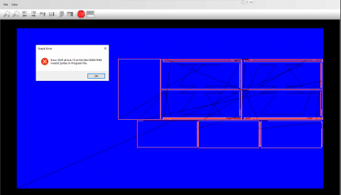

Troy Hollinshead
Posts: 50
Joined: Wed, Apr 30 2014, 4:13PM
Company Name: Leidys Custom Woodworking
Location: Mercersburg, Pennsylvania
Postby Troy Hollinshead » Wed, Aug 28 2019, 7:34AM
Clint,
Still a no go. Here is a screenshot of the error I get when I comment out the offending line of code or change retract height in control nesting to 0.
