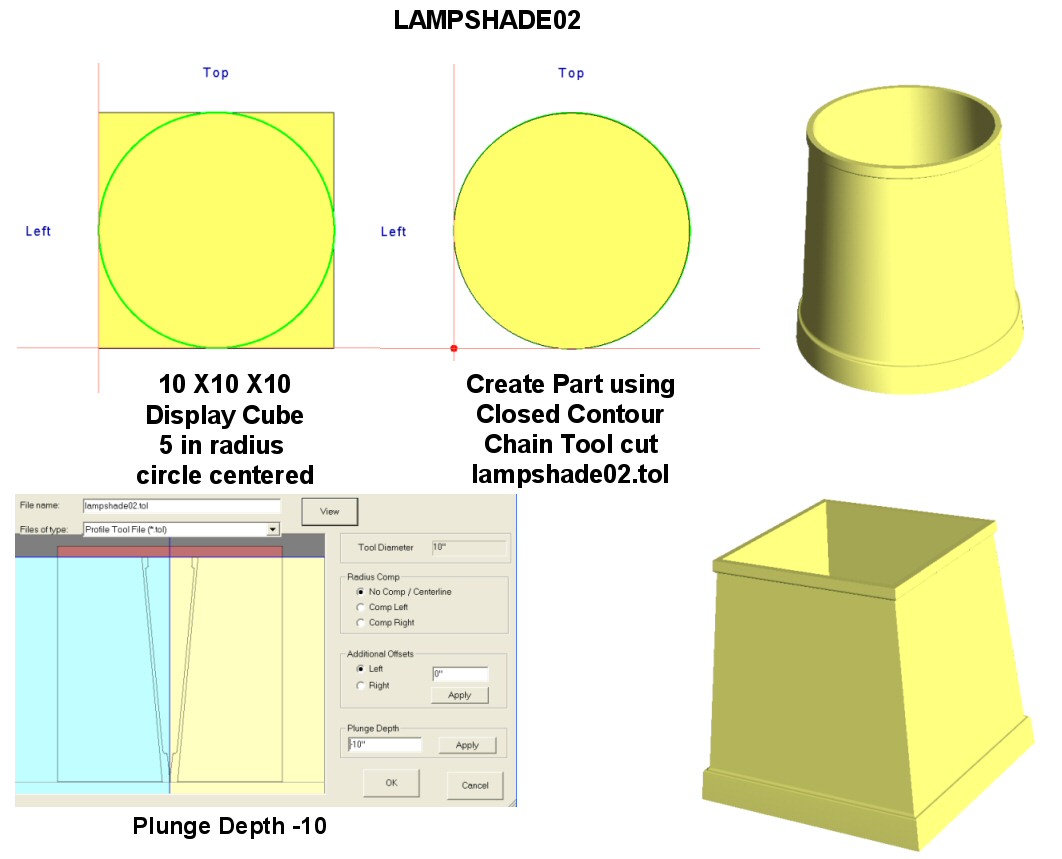

The tol that makes this lampshade could be also used to make a waste basket or a plant pot.
I have included the x_t and dxf along with the .tol file.
