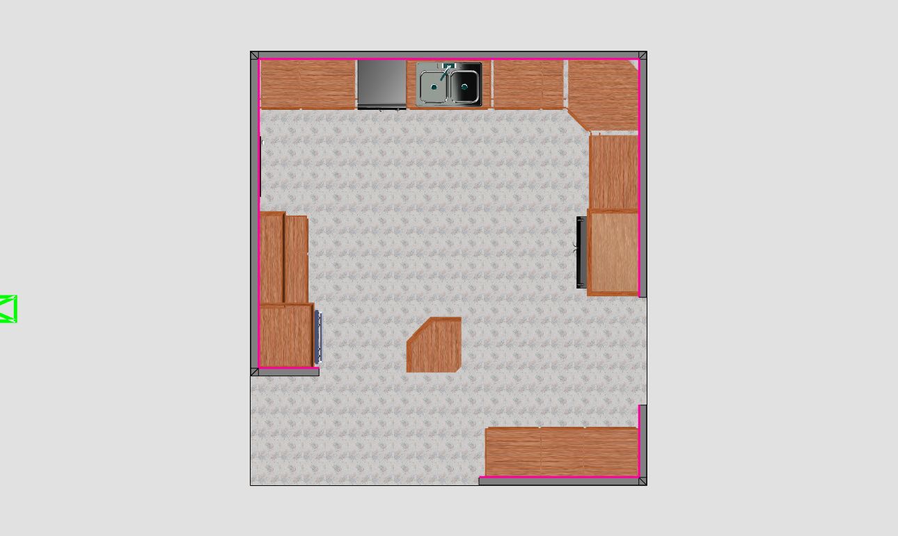

I am designing a job in Build 3 and have a problem when I resize an angled corner upper cabinet when installing it in the detail room. When it is resized and comes into the detail room, it shows as a 12\" wall cabinet. When I click to set it, an angled corner cabinet is set. Below is a picture of both. To the left is the green box that comes into the room after resizing. The cabinet in the middle of the room is what is set when I set the cabinet.
Also on this job, the job will not save after I put the countertop on the island. It frezes up at 17% and will go no further. Posted is the job I am working on.
Forgot to add the corner cabinet was resized from 42\" tall to 37 1/2\" and mounting height lowered from 95\" to 91 1/2\".

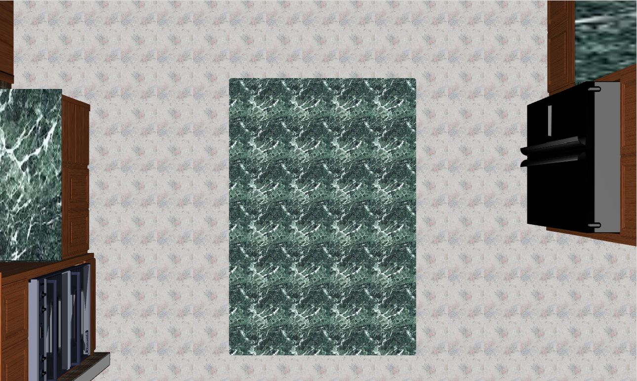

This job has saved several times with 3 of the countertops in the job. Below is a picture with the 3 countertops in the job.
When I put a countertop on the island cabinets is when the job freezes up when saving it. I have tried saving it with other changes with no problems until I add this countertop. And I have tried it at least 10 times.

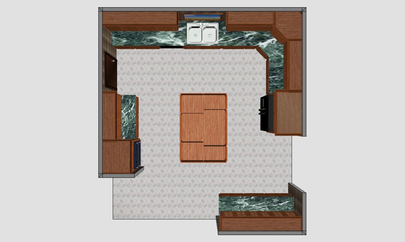

I may have found a fix for this countertop problem. I created the countertop for the island then took it into the part editor. I then put a 1/2\" chamfer on each corner. After doing this, the job saved fine. :D
