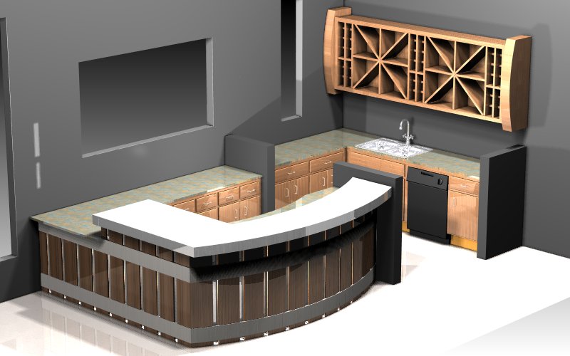

Hi, Nat. Yes, you can do radius work relatively easy in e-cabinets. Attached is a wine tasting room we did with a curved bar wall and tops. To generate the full renderings for the customer took about 10 hours but you can draw and cut the parts needed to fabricate the wall and sub tops in considerably less time. Keep thinking outside the box. This software is very powerful and you can do almost anything you want if you put your mind to it. 8)

Kudos Jerry, that's a fine lookin' rendering. Cool design too.

Nice design Jerry. Is "10 Hours" just hyperbole or did you just do 100 different views?

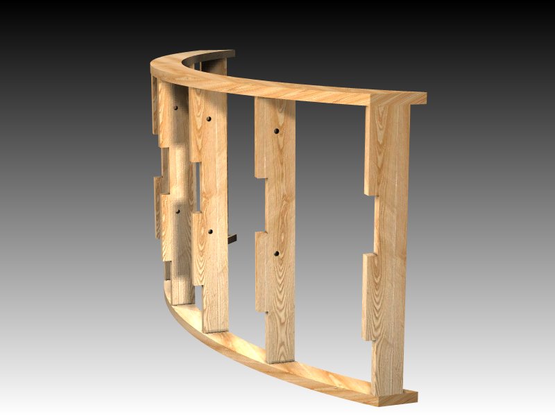

How would you handle something like the studs in the wall, which normally have a number of different cuts in them for wiring toekick etc? Is there a way to duplicate a part like this once you've created all the PE cuts in one? I imagine it could also be treated as a separte item and added in as a batch item in whatever quantity was needed.
Forrest Chapman
Posts: 1261
Location: Anderson SC.
Re: Ease of Doing Curved Units?
Post by Forrest Chapman »
Nat,
Take a display panel and do what ever part edits you want and then save it. Load them into the room or add them in batch whatever you feel.
Forrest

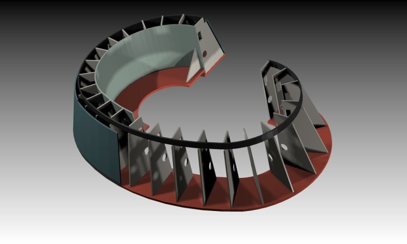

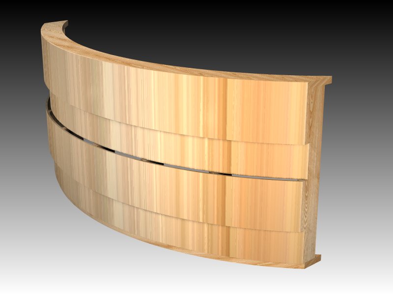

Wall made from a Std Base Frameless Cabinet
I made the plywood out of display Cubes.
The power of Cad

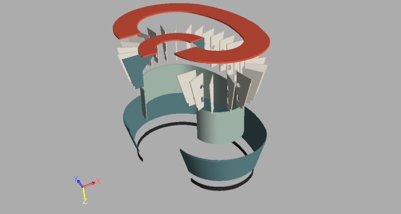

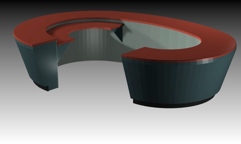

Nat,
This Desk
Was done using display panels so all the parts would show up on the nest
I saved the geometry of the top where I could then place it on two different sheets to nest it
The cone shaped outer skin will not nest. eCabinets won't lay lay it flat. The same goes for the inner skin.
The bottom line is that eCabinets can graphically represent your curved work and for things like the basic structure of this desk it can nest the parts ok but curved stuff is very time consuming and yu won;t be able to nest all the parts tht you can draw.
