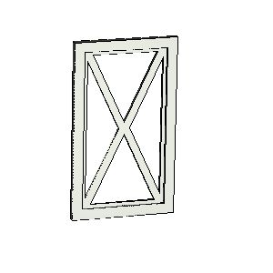

This is an MDF door that is the back of a cabinet. The back is set flush, 1/16" inset on top, deck, L&R sides. There is no top, deck or sides on this cabinet. This allows the door to be 1/8" less than the cabinet size L & W. The pattern is constrained to give 2-3/8" stiles and Rails.
