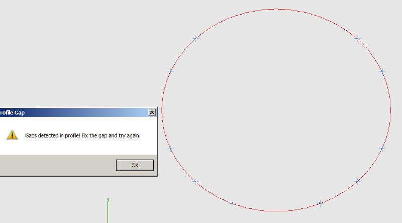

It is your DXF file you made in Delta Cad with a 17" dia and a 15" dia
- Posts: 1585
- Location: Norwood Pa.
Re: Profiling a oval shape
Kerry I see how slow your DXF is in e-Cabinets but then when I put it in ViaCAD and save it as a DXF from VC it is alot faster in EC ?
When I put your DXF in my DeltaCad and bring it out it will not work in EC? Then I took the DeltaCad DXF into VC it opens it all up. Here is a picture of it all opening in the oval.Try the DXF from VC I didn't do anything to it in VC

George,
ViaCad created the oval as just sixteen arcs (Instead of many, many straight line segments) which works great.
It works fine in eCabinets. I am supposed to be able to draw an oval/elipse in Intelicad with arcs but I haven't learned how yet. From what I have read, if an oval is created using seegments it cannot be converted to arcs. it must be drawn using arcs.
An ellipse is one of those geometric shapes that is very complex mathematically. Since I'm not a math guru I wont' get into that.
First, the geometry for a counter top will not export with the cabinet or job file to create the .twd file for the machine. So if you don't have CAD/CAM software with a post, you would need to import a dxf file using Control Nesting to cut the counter top.
My thoughts are that the geometry for a 3 point arc would get you close particularly for display purposes in eCabinets, but maybe not for machining. Of course, the more arcs you use the closer you'll get, but that could be a lot of work, if you had to draw each arc. For one, the intersection of the arcs would probably be out of tangency enough to cause a chatter mark or some mark at the intersections. You can use Tangency Factor codes to nullify some of that or maybe not.
If you are using Autocad there is a system variable for an ellipse called "pellipse" that can be set to 0 or 1. I don't remember which, but it was usable with our old DXF translator and would cut a nice ellipse. So you may be able to import dxf file of an ellipse from AutoCad with the setting changed. Worth a try. Someone mentioned IntelliCad, that product is very, very similar to AutoCad, so that may have the same variable.
Another option for machining on a Thermwood and not for display in eCabinets would be to create a diamond, i.e. four straight lines. When the NC file is created from Control Nesting find the four straight lines in the program. Change the G01's to G12 (clockwise ellipse) or G13 for a counter-clockwise ellipse. When you create the geomtry you will need to account for the radius of the bit for tool compensation, since a G41 or G42 can not be used with a G12 or G13. Anyway, this would provide a smooth ellipse with actually very little trouble for a counter top. It would probably be more difficult to locate the NC code on a nested job, but is doable.
Keep in mind that "G" code programming and editing is always an option. At times, this is the quickest option.
Dennis
