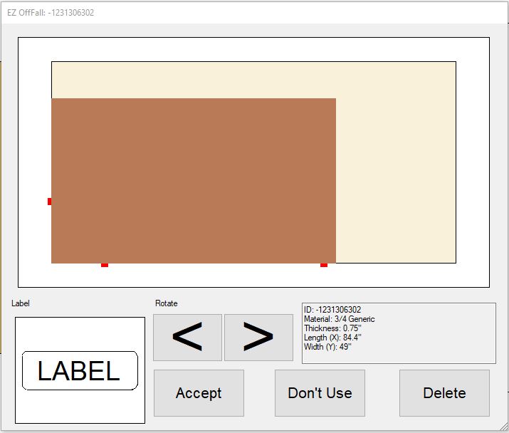

I am using a barcode scanner to scan off fall labels and I would like to be able to scan a code that opens up the EZ Off-Fall dialog box for the next input rather than have to go back to the keyboard. Is there a way to add shortcuts to functions within the program?

EZ Off Fall will automatically launch when an off fall label is scanned, however a dialog opens after it asking if that is the sheet you want, and if you want to rotate it. I believe Alain is trying to get past that dialog without having to go to the control to click accept. See attached picture as an example of that dialog.
I would probably look at programming the barcode scanner as Brad had suggested. The tricky part is making sure you are covered for other instances. For example, if you just add a pause followed by an ENTER click after each scan, what happens when you scan a recut? Or if the scanner is used to open CNC files also, what happens then?
