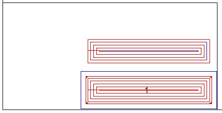

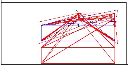

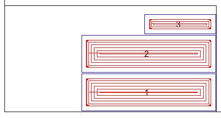

Turns out my assessment of the criteria needed to replicate the issue was not quite correct. Strictly moving parts around on a sheet works perfectly fine. However, the problem DOES occur when moving parts between sheets. See images below.
Now, I created a new empty sheet, and moved the small door to the new sheet... Above image shows sheet 1... And that image shows sheet 2.
The export you asked for is also attached.
As always, thanks for your help Clint!
In the above image, I nested three doors onto one sheet.Now, I created a new empty sheet, and moved the small door to the new sheet... Above image shows sheet 1... And that image shows sheet 2.

Re: Bug Report: Sheet Images
I saw the release notes said that the issue was fixed, so I went to try it out, and while it is still not perfect, it is a huge improvement. At least the sheets are readable now. Some of the lines are not quite aligned properly, or don't quite draw correctly, but WAY better than it was.
