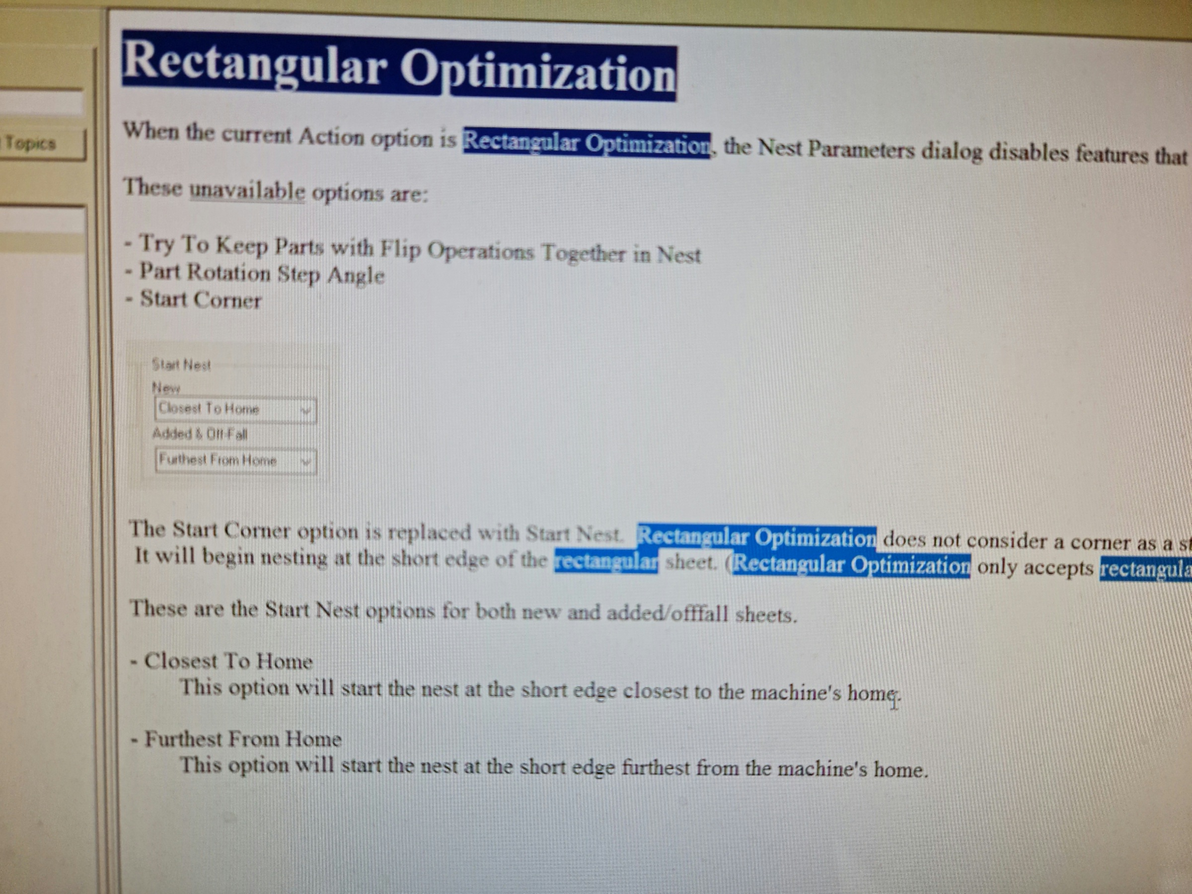

Looked up Rectangular optimization as you suggested
See the little window in the help menu that shows the nest closet to home and furthest from home for offall?
You can call me dumb and blind, But I cant see that window?
I know my nests were closest to home, because I noticed it was different nesting. but I cant find that setting.

Haven't dug into the labels one yet but my day is getting away from me so I want to post to let you know about the profiles issue. There is a bug with profiles and Rectangular Optimization when it is set to Closest to Home. With it set to Furthest from Home the issue doesn't seem to be there. That setting is found under Nesting Parameters.
I'll let you know about labels once I've had a chance to look at it.
EDIT: I looked at the labels issue, it is the same as the profile issue. When it is set to Closest to Home the wrong side is set to label. Setting it to Furthest from Home seems to work. Both issues are reported to software engineers.
