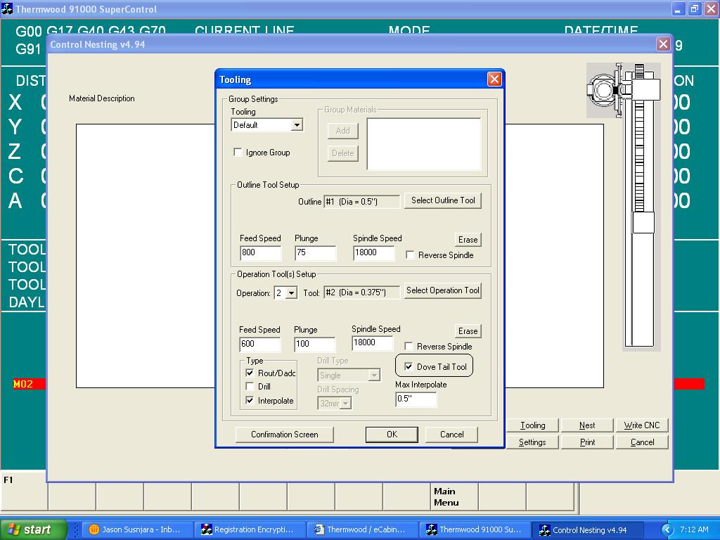

I purchased the tooling to do dovetail drawers on our CS-45 using the new capabilities provided in version 5 of eCabinets software. I can't seem to find any reference to how the tooling should be set up in the router so that it differentiates a 1/2\" dove tail tool from any other 1/2\" bit. Any suggestions?

If you load Control Nesting, go into the tooling area. You need to make an operation using a .375 tool and check the box for Dovetail Tool. You will need to mic the tool at the bottom of it. It should be close to .375\".

Got it. Thanks, Jason.
