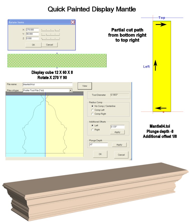

This one is fun. :D I have included the x_t, dxf and tol files. If you can draw your trim profiles you can make a quick model of your mantle. This is just too cool. My design needs some work. I just made up some stuff to try out the ideal. I will have to work on my profiles to get a real model of a mantle we would actually make but it is possible :!:
Mantle04.zip
(30.93 KiB) Downloaded 1544 times

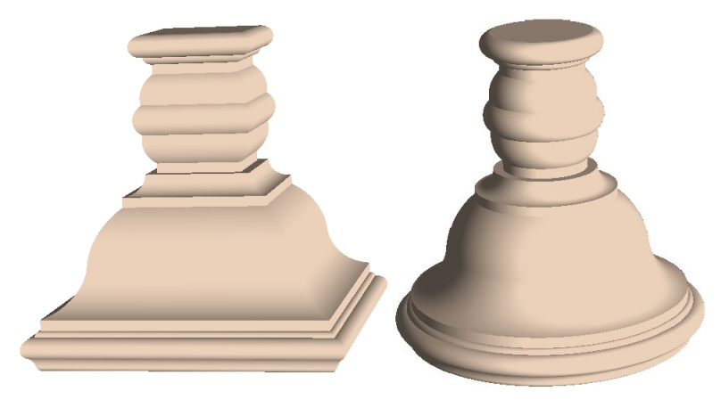

Oh and you can also use this profile to make this or that whatever they might be. I might make a lamp from the round thang. :)
this or that.jpg (67.79 KiB) Viewed 18021 times
