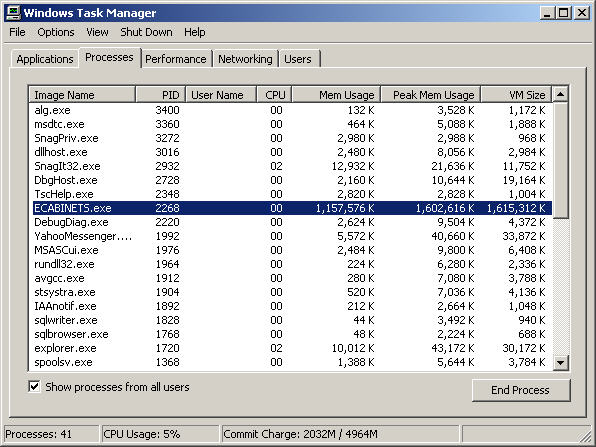

I have the TM open 24-7 and I never get big spikes like that. :?
I guess that's a good thing.

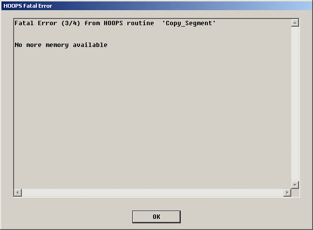

You don't get anything like this if you take a room layout into the Line Drawing Editor?
This is the error dialog I get everytime with this room when I try to make a second copy in LDE.
Memory Usage at Hoops error.jpg (73.92 KiB) Viewed 12155 times
Memory Usage - Hoops error.jpg (27.45 KiB) Viewed 12155 times

I would like to shed some light on this subject. There have been many cases reported on the \"Out of Memory\" error. Majority of these cases have been found upon saving a job. We are diligently working on a new saving strategy to minimize memory usage in this process.
The case with the Line Drawing Editor is a different scenario. Dan, this job you are working with contains some large geometrical data which is 'pushing the envelope'. The majority of the data is from pulls and rope moldings. We recommend to you and all our users to restrain from using these components until final layout steps. Extruded moldings are not too large. It is the repeated moldings (especially the rope) that introduce large amounts of data. If the need for pulls and rope moldings can be avoided in the Line Drawing Editor it is highly advised. We are continuing to improve the performance in this and all areas. Unfortunately the more data you introduce the more memory you will need. Future updates will help alleviate this problem, but until then a minimized approach is your best bet.
Thanks for the input Larry.
Pushing the envelope? Looks more like I was breaking it :lol:
I knew that rope molding and pulls used a lot of memory but I didn't think it would be that significant on something as small as that layout.
I removed all of the moldings and pulls, exited eCabinets and loaded the job again.
This time I was able to create multiple copies of the room layout in the Line Drawing Editor. I stopped after 10 pages of copying the layout and memory usage was about 557MB--MUCH lower!
Granted, the test I just ran is not something one would normally do--10 pages of a complete room layout--but it is good to know that I can do that.
The data structures for moldings and pulls must be gigantic as the file size is only about 3.8MB smaller now (14MB vs 17.8MB).
Also interesting is that memory usage no longer doubled with each new copy of the layout in the LDE. It just may be that if you can optimize memory requirements for moldings and pulls, we will see dramatic improvements in performance.
