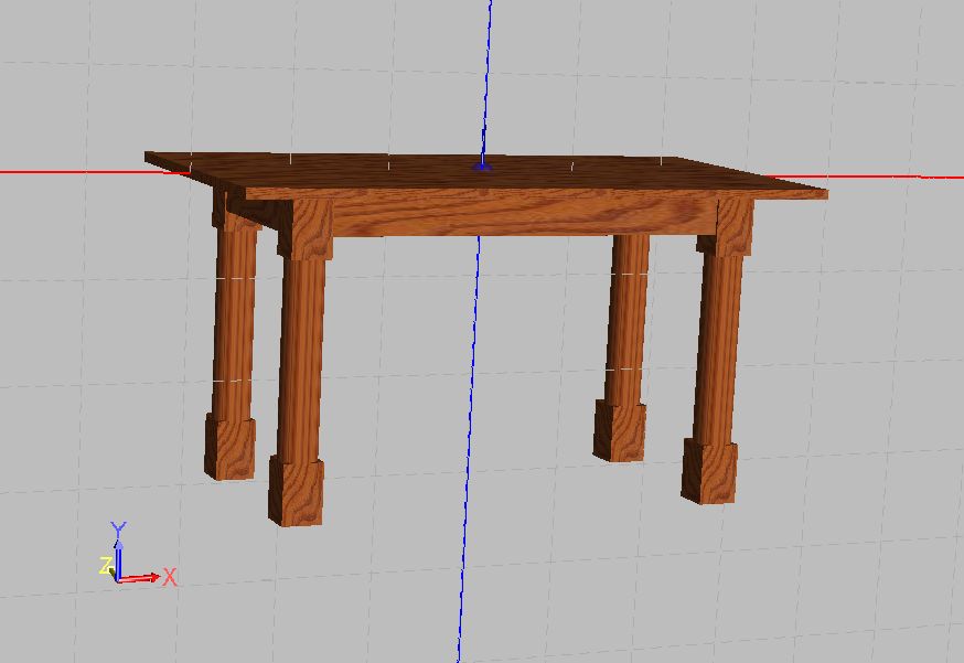

Bite your tongue, (limits of ecabinets). :) You most certainly can draw free standing furniture. You can either start with a cabinet and turn it into a piece or use all display board and panels to create anything you wish.
Here is tableI designed. I know there are others here who have done much more and better than this.

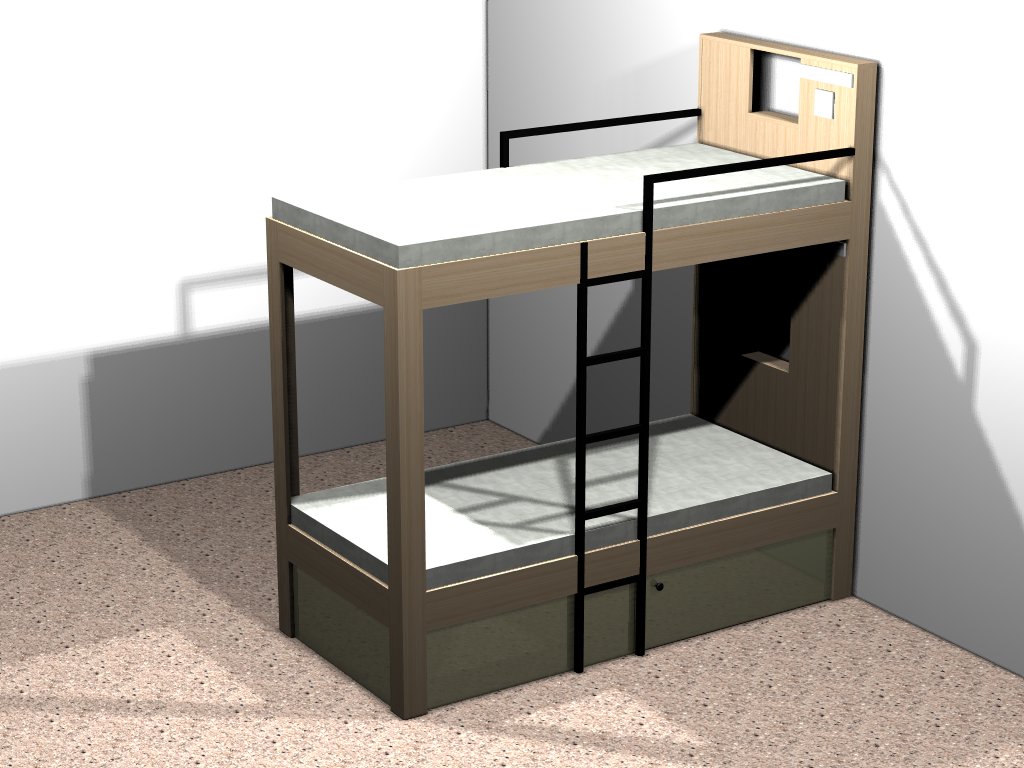

bunk beds for a youth hostel. Overdid the lighting, but it still sold.
Sean

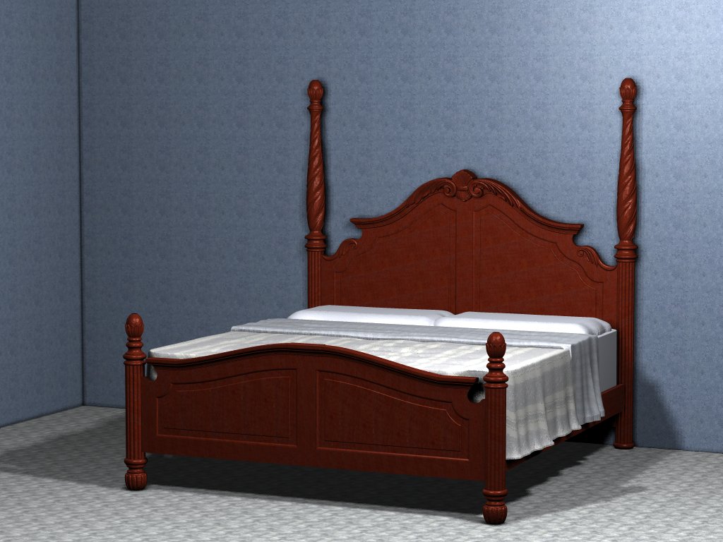

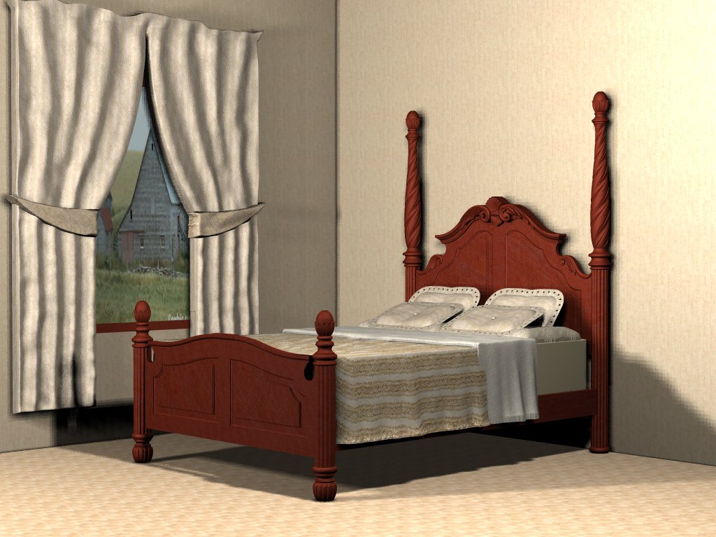

Here's couple of beds..however I did import STL's for the carvings.
King BED1.jpg (119.74 KiB) Viewed 17308 times
Take a look at some of the pieces in The Thermwood Furniture Network.
These are downloadable designs so you can get a good look at how to use eCabinets for furniture design.

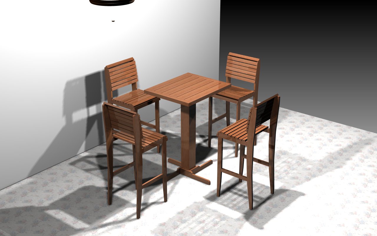

While everyone is showing off, this is a cocktail table and stools that I'm currently working on. Built exclusively from display boards.

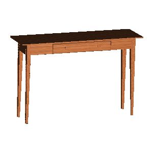

Here's a shaker hall table that we do as a class project at the CT Valley School of Woodworking. Like Kerry, I did it with display boards and even modeled the mortise and tenon joinery. I did the two sided taper on the legs in Alibre Express, a free cad system, then imported them as STL's.
However, not to be outdone, my good friend Leo Graywacz took the challenge and actually did the tapered legs, on two adjacent sides mind you, all in the part editor.
Then he told ME I have to start thinking outside of the box...go figure.

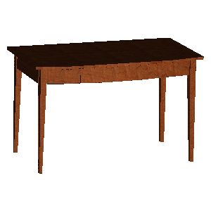

...and along the same theme, a bow-front writing desk...
