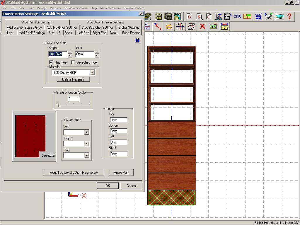

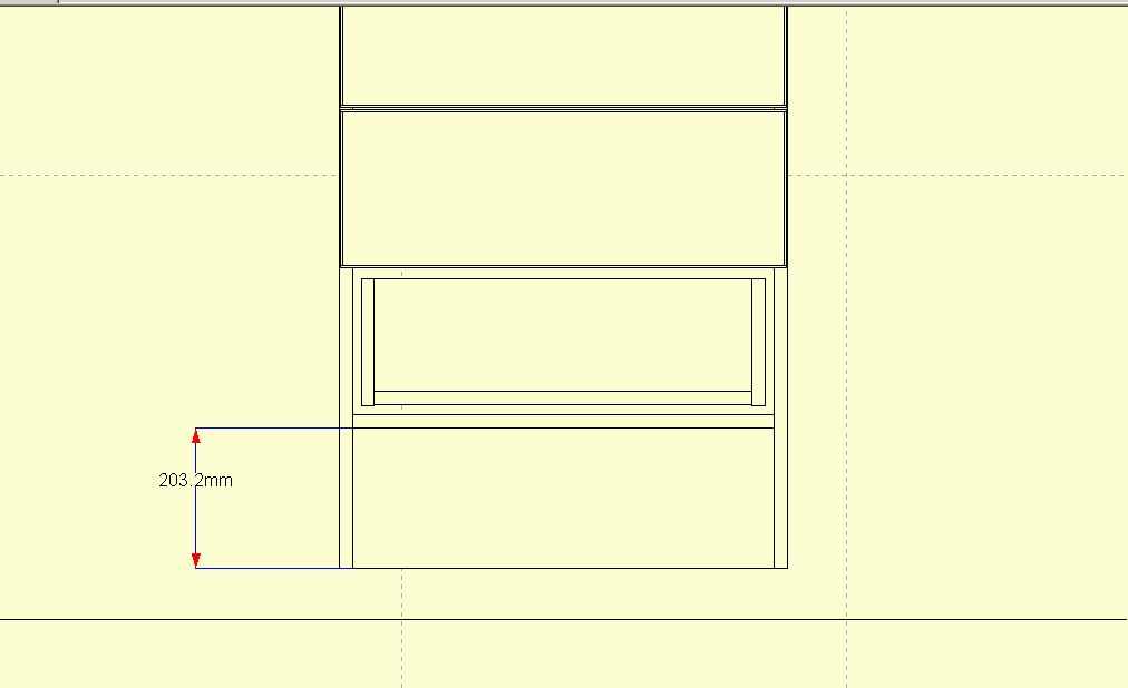

I have a unit here that every time I go to add a toe kick it doubles in size. Here are a couple of pics and the job.

Hi Wally don't know if this is what you're looking for but if you lose the bot inset on your deck and give it a toe kick hieght of 4\" it seems to work :)

Michael RA Greschuk wrote:Hi Wally don't know if this is what you're looking for but if you lose the bot inset on your deck and give it a toe kick hieght of 4" it seems to work :)
Thanks Michael that did work. I lost my part editor cuts but wasn't too hard to do them over.
