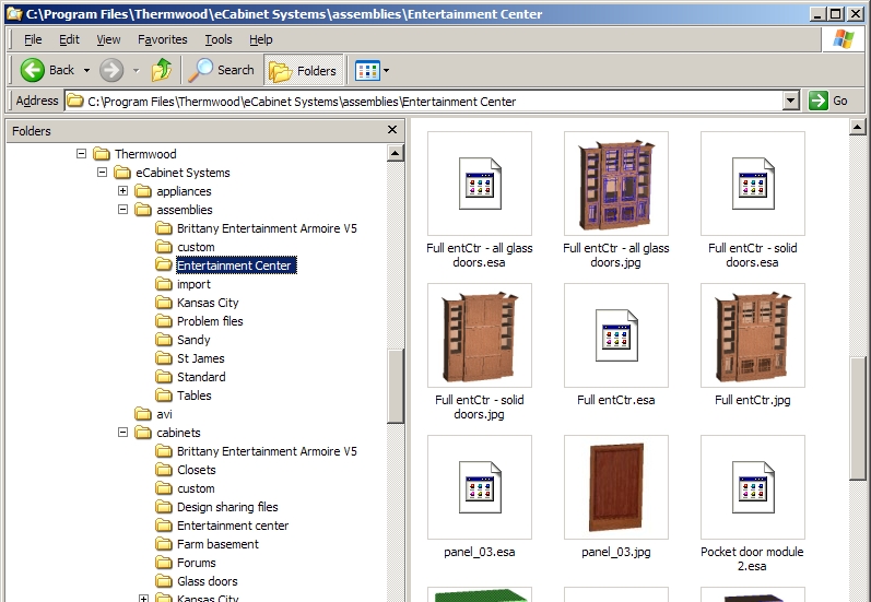

3. Where do you place the files when moving them from laptop back to the desktop? The files must be within the eCabs folder, in their respective directories. I attach an image, below.

Assembly files appear to not even be associated with anything in the system, as the image I posted above shows; as a result, when I double-click them, I always get a dialog box requesting to identify a program to open the file. These must always be opened from within eCabs too.

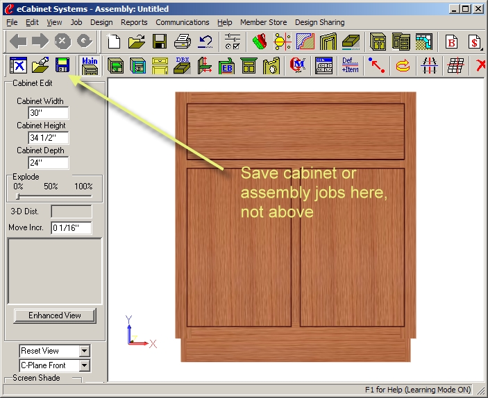

Cabinets and assemblies must be saved from the Editor area, not in the Custom Layout area

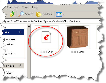

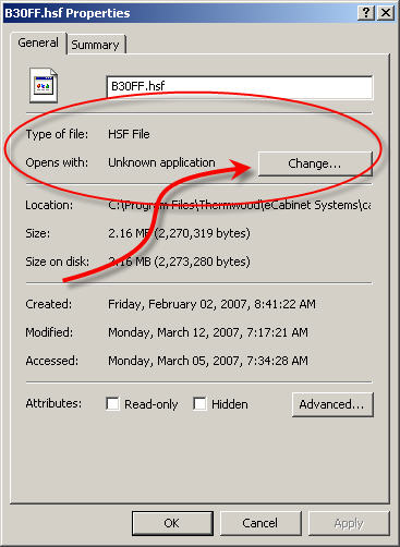

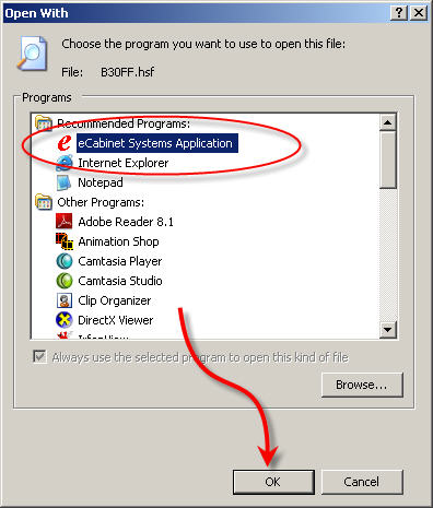

Right-click on the file type you want you open in eCabinets by double-clicking the file...HSF in this case.
Select \"Properties\" from the context menu. Notice there is no \"Opens With\" association.
Click the \"Change\" button and select eCabinets from the list. If it is not in the list, click the \"Browse\" button and navigate to eCabinets.exe.
Click the \"OK\" button.
Your file can now be opened by double-clicking it. :D

DanEpps wrote:Out of the box this is true, but you can change it. :D ...
Dan,
I still get the error message "Invalid file type". After I associate the file types, and then I double-click on a cabinet file with *.hsf file type, eCabs launches and opens at the main menu page, but this error still shows up - nothing comes up.
The same is true of all other file types, except for *.esj :? .
Al
Hmmm...me too. I didn't test it (oops) to see if it would actually work :oops: .
It looks like eCabinets is expecting only an ESJ file to be opened in this manner or is expecting a missing parameter to be supplied in the \"Opens With\" value.
