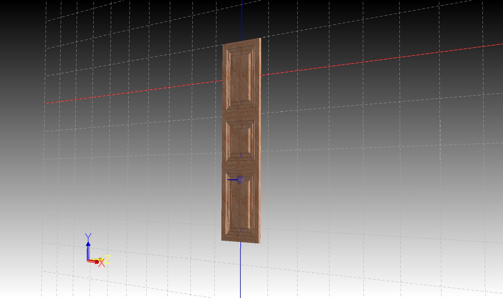

Kevin, another option could be to use doors as an end panel, you could take two or three doors and make a nice looking end panel.
Damon Nabors
Here is an example
Here is an example
3door end panel.jpg (116.96 KiB) Viewed 14193 times

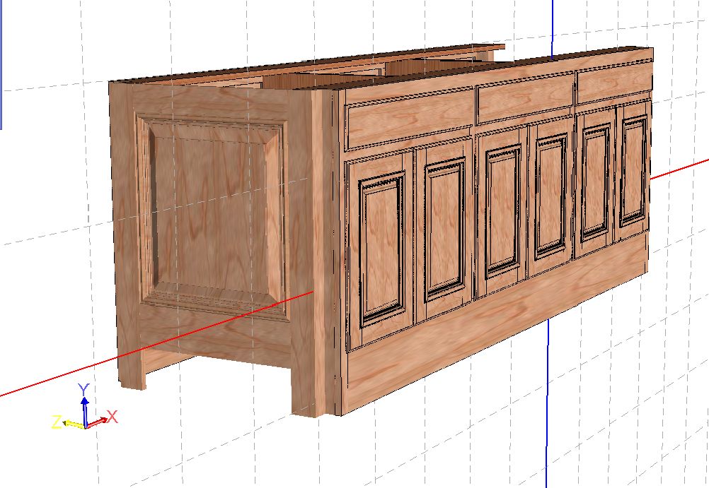

Damon - I thought about doing this, but I couldn't figure out how to change the width of my stiles and rails. I need the stiles and rails on the end panel to be wider than they are on a typical door. The way I actually built this cabinet was to make the bottom rail a couple inches wider so that it drops below the height of my baseboard, giving me something to nail the base cap to. It's not really necessary for the panel to do that for the purpose of this drawing, but I would like to show the wider stiles and rails. Here is a JPG of what I have so far.
TV Lift Cabinet.jpg (118.04 KiB) Viewed 14170 times

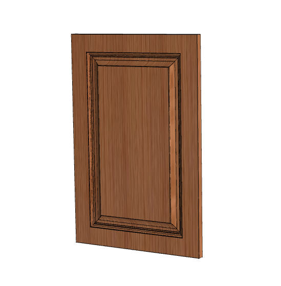

Start with a standard frameless base cabinet.
Go into Construction Settings and uncheck left end, right end, deck, top and toe kick (be sure to set toe kick to 0\" for both height and inset).
Now you should have just a back. Size the cabinet to be whatever you want then take the back into the Part Editor.
Once in the Part Editor, go into Contour Mode. Select the Line tool and place perimeter lines for the inside edge of your rails and stiles.
Exit Contour Mode and click the Profile Edge icon. Leave it on Chain and click Next.
Select one of the MDF Asymmetrical tools, set the plunge depth and offset.
Complete the profile cut and return to the Cabinet Editor, saving the changes.
Now go into the Constraint Manager.
Select the Horizontal Dimensioning Tool and click on the top (left or right--doesn't matter) corner of the part. Now click on the corresponding corner of the profile cut. Click a third time to locate the display of the constraint dimension.
Repeat on the bottom of the part.
Now switch to the Vertical Dimensioning Tool and repeat the same steps as in horizontal constraints (above).
Exit the Constraint Manager and save your cabinet (but give it a \"door\" or \"finish panel\" name).
You now have a resizable \"door\" or \"finish panel\" that can be added to any cabinet and saved as an assembly. You can also add it to a room layout and place it anywhere you like (wall, ceiling, etc).
Resizable Raised Panel.hsf
(324.02 KiB) Downloaded 1061 times
Resizable Door.jpg (28.86 KiB) Viewed 14152 times
