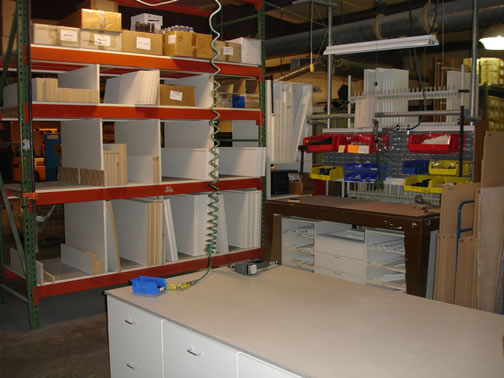

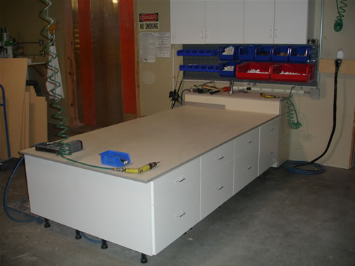

I snipped these pics from the True32 site, and they show an ideal assembly table. Just the right height, all the gear right there, and the parts rack adjacent.

Bob Buckley over at True32 says 8 minutes are what you need for each wall cab ass'y, with basecabs averaging 12 minutes assembly time.

That assembly table looks like a hospital bed... :) mine has gobs of glue hanging off it, putty smeared everywhere, staples and nails sticking out of the legs...crap all over it....

You are saying it's a \"studio\" shop, Dan? Not a real one?
The reason a True32 shop like Buckley's (the table shown is in his) is clean, is because no glue is used in carcase assembly, and because they want it clean when working with finished ends.
What's wrong with a spotless shop?

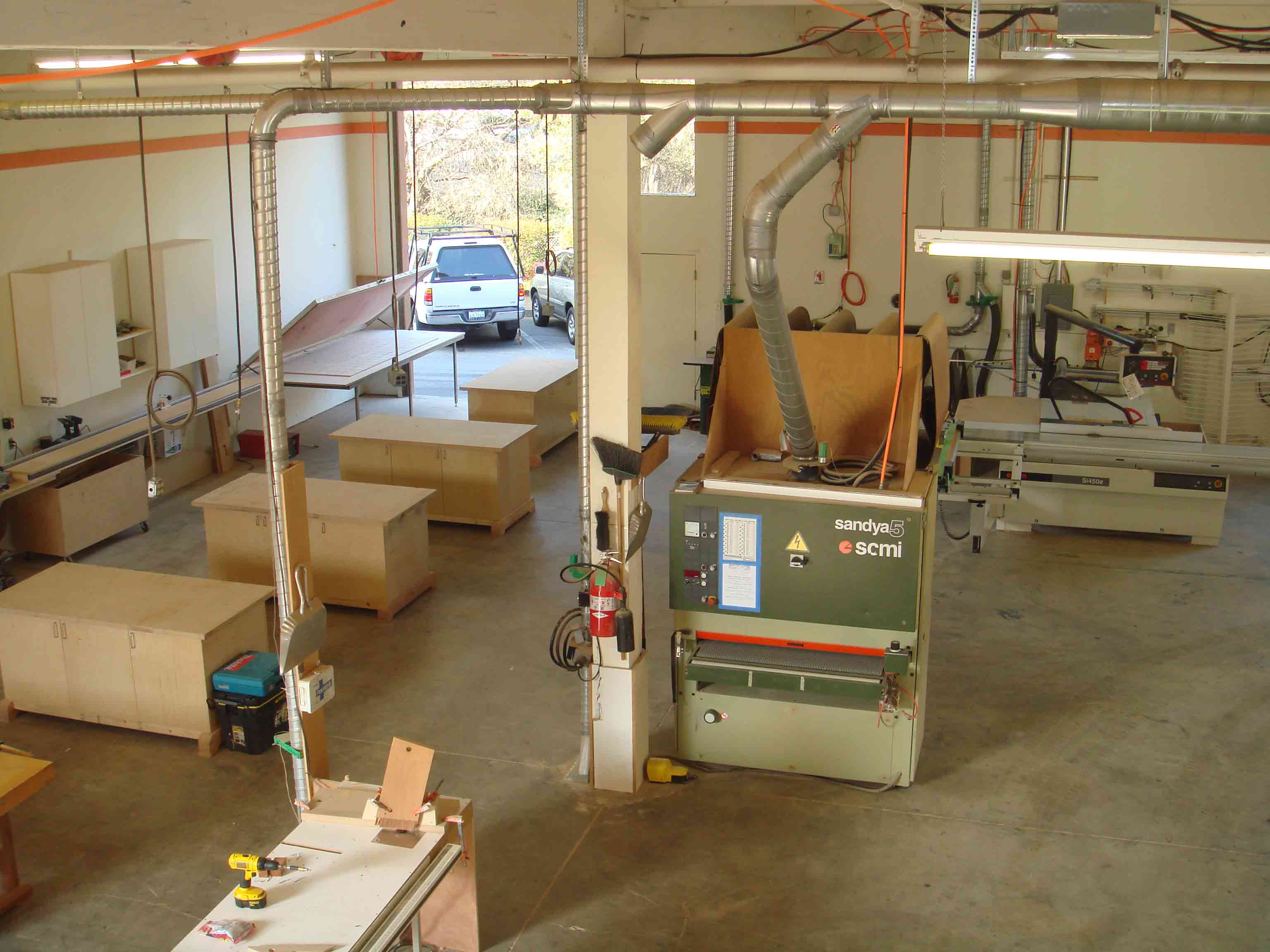

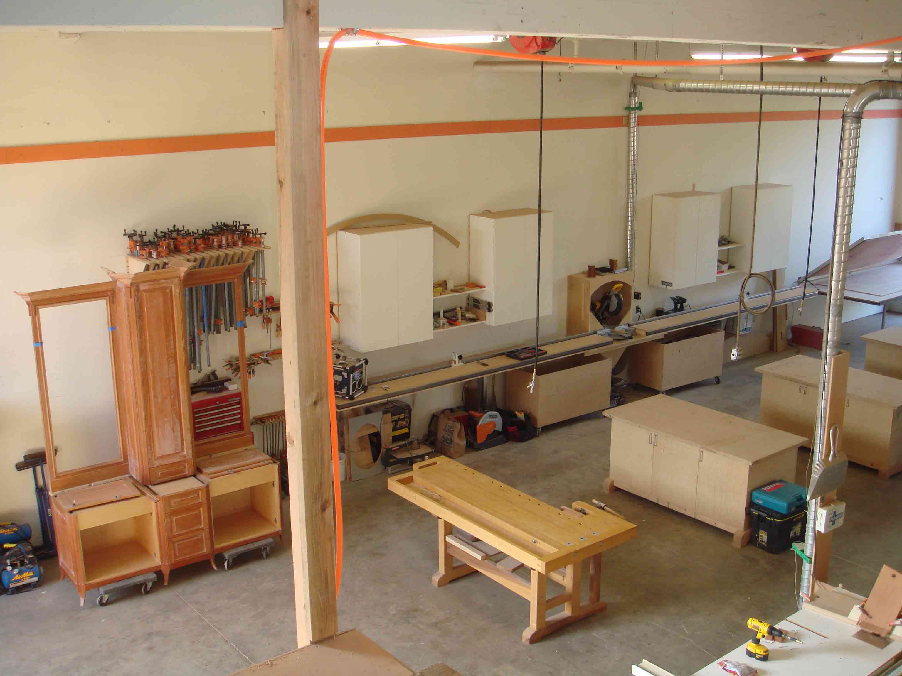

From WoodWeb's shop gallery pages, here is Chad Reitan's shop, near Santa Cruz, CA. He builds very impressive stuff. See the veneer press near the door?
May we have some photos from your shop?

Well lets see....
The first thing I notice is the complete lack of safety lines anywhere in the shop.
Secondly I see some extension cords hanging from the ceiling on the back wall, this is a huge OSHA no no.
Then I notice the column with the fire extinguisher on it, where is the federally required sign showing the location of the extinguiher?
If you zoom in very thight to the right of the chop saw I can see a light switch without a cover.
Just in front of that is a 4\" sqaure outlet box hanging from a piece of what appears to be J cord, another no, no. On top of that there is at least one knock out missing from the outlet box without a shield, talk about a dust trap.
Toward the back of second picture I notice another fire extinguisher without a sign, and an electircal panel without the required 3' of clearance.
Nowhere do I see any signs about shop safety, the use of protective gear, etc.
Before you ask, pictures of my shop have been published in a few different magazines, you are welcome to search back issues and find them! My shop is far from perfect, but then I am not trying to hold it up as an example of a perfect shop.
