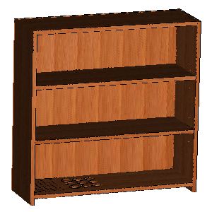

I was not cutting a full dado, I was making a tooling cabinet to hold my tool holders and bits. It has a series of holes ranging from 1/2 down to 3/16 drilled .375 deep into one of the shelves so the bits can slip down into the holes. I made each hole .005 larger to make sure they where not too tight. Other than the holes, it was a standard cabinet with blind dado's. I am going to run the program again and write down exactly what the error message said and re-post.

Ok, when I load the program, It pops up with:\"There was a problem finding an appropriate tool for an operation, Please check the cnc file......\"
I then scrolled down untill I get to sheet 1, part 5,...
\"error: tool size: 0.375 not setup in tooling (pocket clean up)
I do have a .375 tool set up but it mics out at .3665. If I am at the screen where you select NEST, TOOLING, WRITE CNC, ......If I click the tooling icon, tool .375 has a tolerance of .001.
If you look at the Deck of the cabinet, I cut a 1/8\" pocket 2.27\" in diameter, and a through cut in the center of the pocket 1.27\".
If I go to my tool setup screen and change the diameter of the tool from .3665 to .375, the program runs ok, but I have an incorrect actual tool diameter.
Damon
