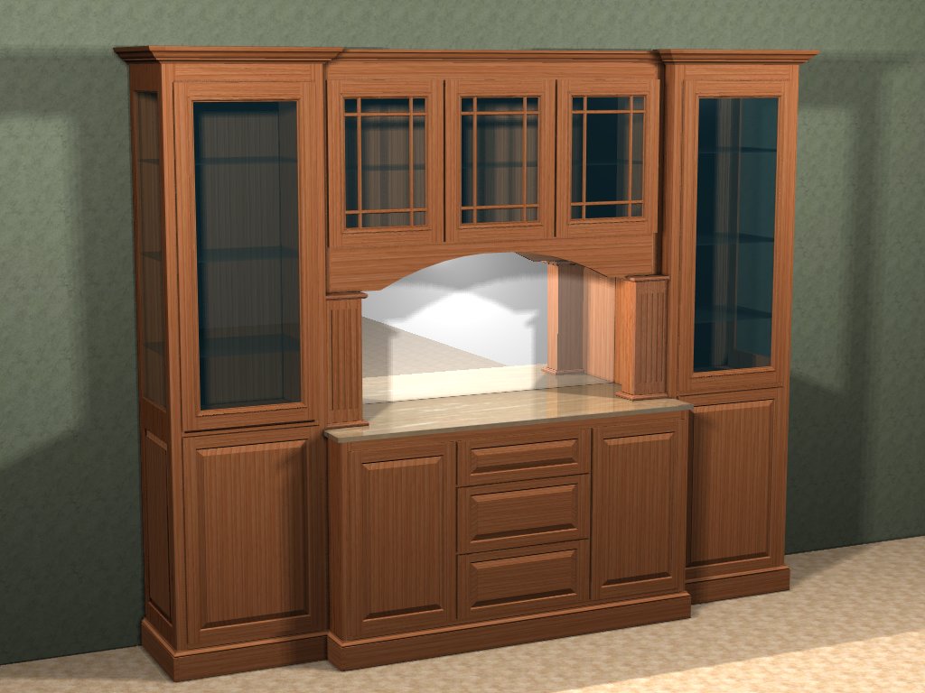

Since I was trying to finish up last night, I just deleted the sub-assembly and brought the original back in and it edited fine. Four cabinets make up the assembly and only one gave that message so I got past it with little effort. Thanks - this program is the bomb!
Hutch 4.jpg (113.29 KiB) Viewed 9224 times
Lookin' good Tony.

Thanks! Just sold my first kitchen because the folks could see what they were getting with awesome pics, This program is awesome! Thanks to this forum, you have been a wealth of info so far!
