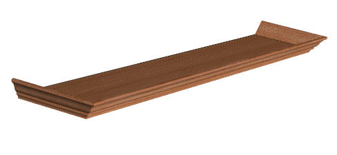

You can make a "resizable" top molding by starting with a standard frameless upper then removing everything except the top. Set the default top molding and add it to the cabinet and save the cabinet.
Now you can create your assembly of cabinets as Todd describes then add this "cabinet" to the assembly, resizing it as needed. You can also add this to a room layout after placing all the cabinets on a wall. Just measure the length of run and resize the molding cabinet accordingly.
You can make one of these for each style of crown that you use and quickly add them to your jobs.

Todd Miller
Re: How to "batch" cabinets
Post by Todd Miller »
Dan,
Excellent! I will have to remember that one.
