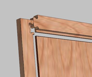

Like this door?...it is actually a cabinet though. There are constraints on the back rabbets so you can resize the door. You will need to add these through the assembly editor, instead of the door editor.
Also, the top and bottom rail will require a flip operation. Because of such a small part, I might consider doing it on a table router....or use double face tape to hold down.
