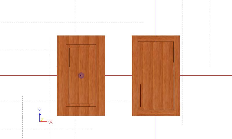

Tom, you can take a MDF door and profile the door with a raised panel tool and apply it to the cabinet for display purposes. The grain will run the wrong way on the rails, but you be able to get a feel for the proportions of your layout. Here are two doors. The one on the left is a mdf door with 4" rails/styles, the one on the right is the standard conestoga crp-10

Thanks I am new to this. Which profile tool did you use? I tried a bunch both interior and exterior with no change when resetting the image.

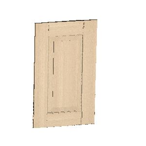

Here's a 5 piece door with 4" rails and stiles, which is actually a cabinet. (It has all parts deleted except the face frame and back.) Resize as you would any other cabinet.
4 inch Rails n Stiles.jpg (7.33 KiB) Viewed 11850 times
