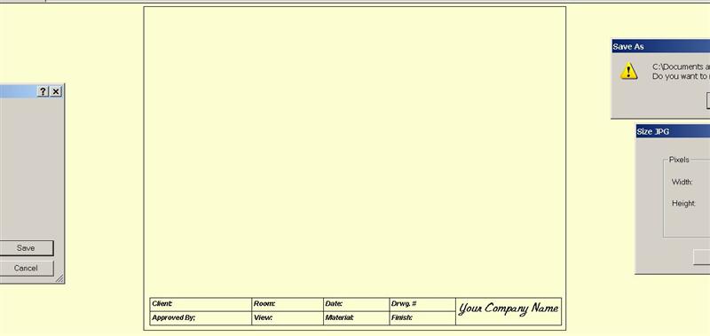

Re: Title blocks-how to do them?
Dave ,
Here is a simple title block that use. Just start all your new jobs with this file and change the file name after you begin creating your job. You can than copy and paste the title block to new pages added within the LDE in the job you are currently working on . ( Not from job to job)
Just change the content to work for you.
Hope this helps
Vince
CCS woodworks inc.
Hope this helps
Vince
CCS woodworks inc.
- Attachments
- JOB TEMPLATE Generic.esj
- (3.77 MiB) Downloaded 437 times
- Job Template (Medium).jpg (19.44 KiB) Viewed 3946 times
