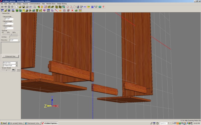

The reason I asked if you are trying to rotate it 180 or whatever, was because I had a hunch that you are trying to get the tenon on the back side of the stretcher, rather than on the front. Rotating the stretcher will create problems. What you need to do is: go into the stretcher editor and then click on the stretcher ( turns green w/hash marks), now go up to the top and click construction settings, then go to the construction parameters (left/right -up / down) when you get into the construction parameters, change the tenon bottom side/tenon top side radio button. This will reverse the tenon and everything will work the way you want it to. That is if I understood what you are after. Here is a picture exploded with the tenon switch on the left stretcher.
Thanks Damon .... That's exactly what I was after and it worked great. I learned another lesson tonight.
