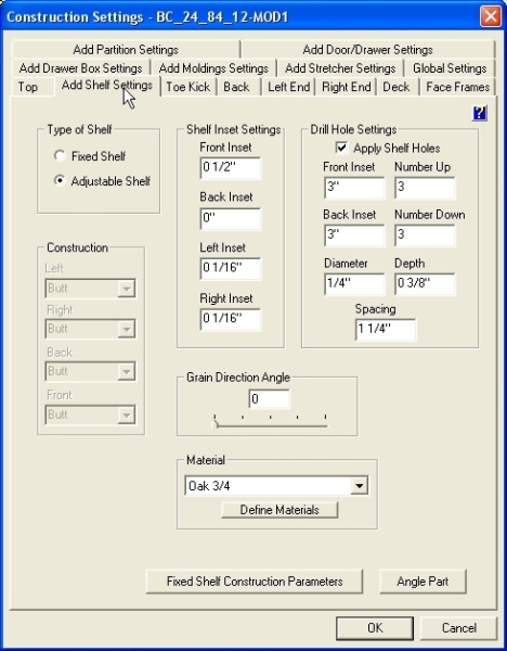

I am trying to build a kitchen so I can send the esj file to a Thermwood CNC member. They sent me their "seed" cabinets so I could have their specs. Is there a way to printout the construction settings? I am having to write down the specs and add them into my cabinets. It can be done but very time consuming. I guess I could start all over and use their seeds, but I rather not.

You can use the screen capture function of the eCabinets Image Control (Irfanview)
You open the Image Control then click on Options then Capture Screen shot
Choose the Foreground window option (set a destination Directory) then click start
Open one of the seed cabinets then open construction settings
for each tab of construction settings hit ctrl plus F11 and it will capture that construction setting screen as a jpeg
you could then print out the jpegs.

Thanks that will work. Since it time stamps the files, I can plan the order of the tabs captured and find the one to double check. I plan to bring the jpg up on screen while I have my original in the editor, saving paper.
