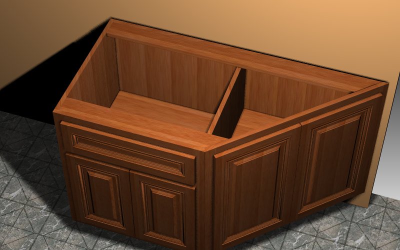

Brian, is this what your looking for?
angled.esa
(1.27 MiB) Downloaded 1031 times
angle 2.jpg (75.47 KiB) Viewed 15401 times

But is it possible to have say a 48" long cabinet with 32.5 degrees cut off one end from back to front,so when two cabinets are put together in a corner their face frames meet at a miter? I have a whole job of these, a whole kitchen anyways. Can it be done with offsets or do i need to spend a week in the part editor to get these done?
Thanks for the other Cab too it will help to see the settings:)
Is there any plans for an angled cabinet in the standard cabinets anytime soon? Not the corner cabinet but a linear cabinet withan angle in either or both ends,or is that what the corner cabinet is for?
Thanks Brian
This is a 48" cab with a 45deg angle on one end. This one is pretty easy with just part editor modifications.
