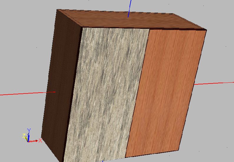

Re: Plastic laminate
Hey Joe, you can apply PL to anything in the program. What I did here was make up a sheet stock item, brought it into the CE and applied it to the cab door using the align items feature. If you want to add PL to the wall then start with a cab, remove all the parts except the back, make the back from PL stock, add this to your library, go to your room, load item, adjust size and install height, then place in room. HTH

Joe Redburn
Posts: 18
Joined: Thu, May 08 2008, 7:11PM
Post by Joe Redburn »
Rick,
Great Idea,
Just what I needed.
Thanks again for the help, it is really appreciated.
Regards
Joe

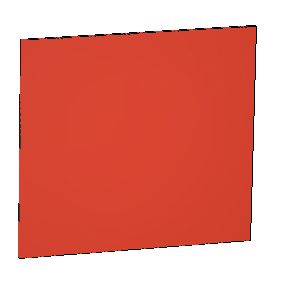

Joe,
If you use two cabinets then you will have to save it as an assembly and the two cabinets will have to be re-sized individually. I don't know of an easy way to get laminate on both sides of your partition and be able to re-size them. The assembly method you are using might be the best.
Joe, this might work for you.
