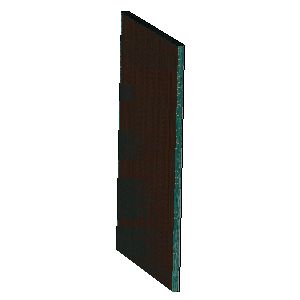

Rick,
I took a base cabinet, shortened the sides so they flush to the deck and top, inserted a partition, changed the sides to laminate, changed the partition to one inch plywood, set the cabinet width to 1 1/16 " and I now have a toilet Partition Panel that I can stick to a wall and resize it at will. Everything shows up in the cut list and when I get the hardware imported and attached, the whole thing can be machined.
Thanks for all the help, your advice got me started.
