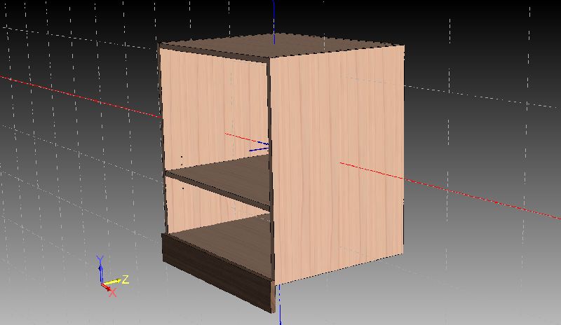

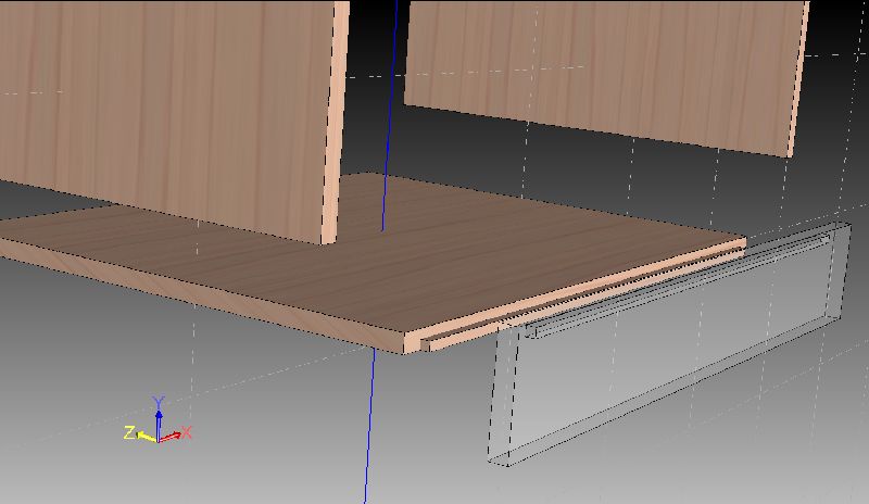

Nemanja, if you are trying to do what I have ilustrated simply make the face frame material sheet stock, delete all of the face frame parts but the bottom rail, and make the deck blind dado into the face frame. Hope this helps. If I am totally off base let me know. 8)

Justin Melhiser
Re: toe kick
Post by Justin Melhiser »
Nemanja
I forgot to add that you will have to add face frames to this and delete all but the bottom. Just like Jerry's post, then you can add a blind dado to the FF and the deck.
