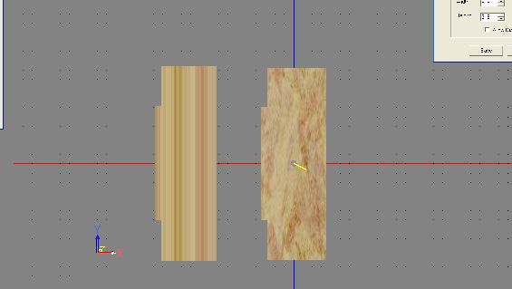

Kerry YOU DA MAN Heres the cubes as you can see I definitly had a few issues before I got it right
DISPLAY CUBE WITH MARBLE TOPS.jpg (18 KiB) Viewed 4671 times

Al I have had this problem with cutting sink hole is counter tops. Had to use a display cube like Kerry says.
