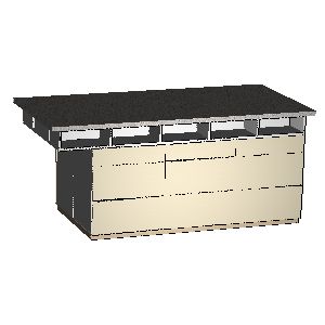

Hey Dale, here's one we did a couple of months ago. We attached our duct collector to the bottom of the overhang and added a removable panel in the center of the top with slots in it for sanding. The center cubby on both sides were blanked out with a panel which contains air, plug-ins and 2" dust ports. A vise was added to the right side, flush to the top.

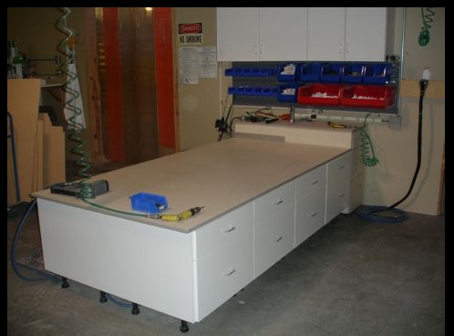

I agree with Michael, the table the True 32 guys use is one of the best I have seen.

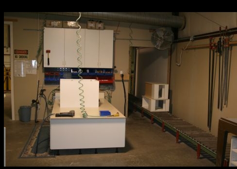

Here are some shots of Buckley's table.

That IS a nice table design. I would only suggest shallower cabinets so the 4x8 top hangs over @ the sides a couple inches(mm's) to allow room for clamping things down to the table top. Just my 2 cents.
