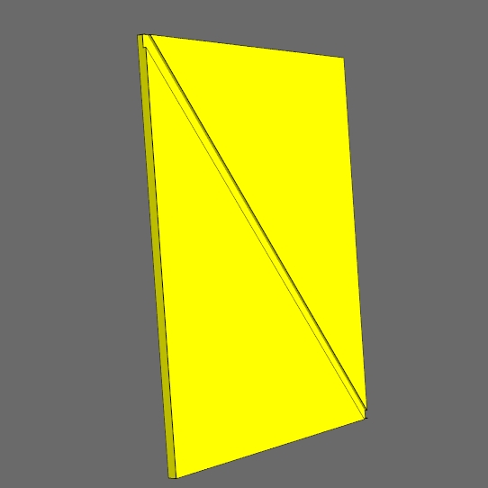

Does anybody else have this problem, as shown in the attached picture, when using dado construction then taking the case to the parts editor? If i change to butt joints this problem goes away.
Rob
Re: parts editor problem
Robert,
This has always been a problem with full dadoes. I think the way I have fixed it is to switch to blind dado construction and have a 0" front tenon inset and then set the back tenon inset to whatever length my cut was in the part editor. You can cut the "tails" off in the part editor but every time you re-generate the cabinet they will re-appear.

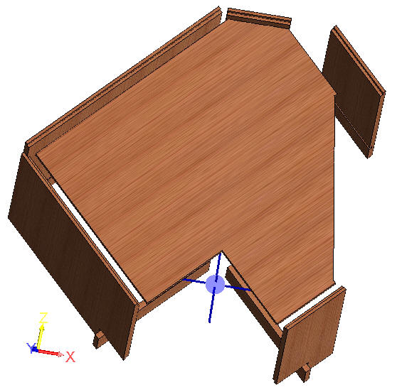

Hi Robert
Would this be what you are looking for.
I set my side and back to the size I wanted then cut out the top and bottom

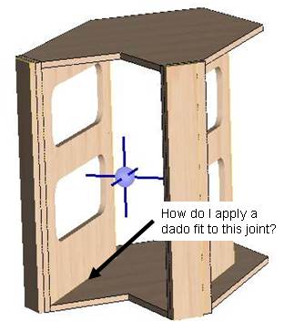

George,
Thanks for taking a look at my problem. In the picture I have tried to point out my specific issue. This case started as a standard corner cabinet and I have been modifying it in the parts editor to create a case for a space corner. The panels with the large cutouts are there to support the slides and I added those through the cabinet editor using just the "insert panel" option. This all works but I would really like dados at the joint between the panels and the deck and top.
Any ideas?
Robert,
You would have to take the part to the part editor, define the path for the dado and use Cut pocket using geometric shapes or Cut pocket using closed contour depending on what you used to define the dado path. The pocket would be cut the depth of your dado.
You would also have to extend the length of the other part the depth of the dado for your tenon.
Not an easy way

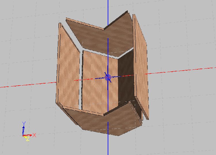

Just playing
Corner Cab.jpg (61.9 KiB) Viewed 18304 times

Kerry - I thought about just cutting dados in the parts editor but I'm not sure you can create the geometry necessary in that direction. It is at a 45 degree angle and the geometry tools only go 0 or 90 degrees.
Rob
Rob,
If it is on an angle you will have to define the path with the line tool in Contour.(right click and make sure you dont have Ortho checked) Then you can use Cut pocket using Closed Contour to make the dado.
