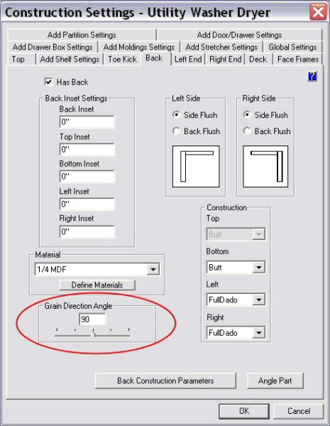

Anyone got a trick to nest over width parts?
Re: Over width back
I am not sure if this is your problem but you can get the back to nest the other direction by changing the grain direction. If this is not your problem them you might want to define a larger material for your back. Of course cutting such a piece could be a problem.

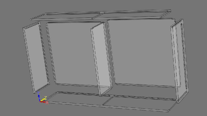

Re: Over width back
Georgi,
Take a look at the attached cabinet. I get construction all around.
Make sure you put a left inset on the back and place an up down stretcher on the left side. there seems to be a bug in the software if you place the stretcher on the right. the right side doesn't show construction.

- Georgi Baltov
- Posts: 341
- Joined: Sat, Mar 10 2007, 7:31PM
- Company Name: Top Notch Cabinets
- Location: Oakville, Ontario
Re: Over width back
Kerry,
try making the same thing with a full dado. Start all over and instead of blind dado construction use full dado. If you try to change the existing stretcher you will succeed. Tell me if you can get it from the first time. I did everything the way you told me.
I tried with 1/2" full dado and it didn't work. I switched to 1/2" blind dado and it worked. Then I changed it back to 1/2" full dado (clicked on properties for the part and manipulated the part from there) It worked and I get the construction and machining the way I want it.
I don't really know why it acts like that. Try it so at least I know if it's me or the software. Thanks

Re: Over width back
This post is for future reference if someone encounters the same problem as I have.
If you decide to split the back and use a stretcher for the second half insert it with blind dado construction (or just leave it with the default construction - blind dado is default for me. I will try later full dado global construction), then adjust it and after all that in the part properties for that exact stretcher select the construction settings that you would prefer. this way you will get that construction on all sides of the stretcher rather than just the parts that you selected initially to place a stretcher in between.

Re: Over width back
Georgi,
I switched to full dado Globally and everything seems to work fine.
I do think there is a little bug in this when I try to add the stretcher to the right end. I am going to try to isolate that problem and report it.
