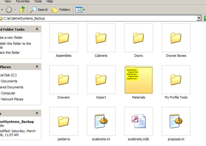

Re: Back up issue
Actually, C:\eCabinetSystems_Backup will be a directory that contains other directories and files, not a single file]. It should look like this screen shot:
Backup Directory.jpg (58.23 KiB) Viewed 29238 times
Make sure BOTH computers have the backup location set to C:\eCabinetSystems_Backup.
If you want to post the message in French, that's okay...I think I can read it.
