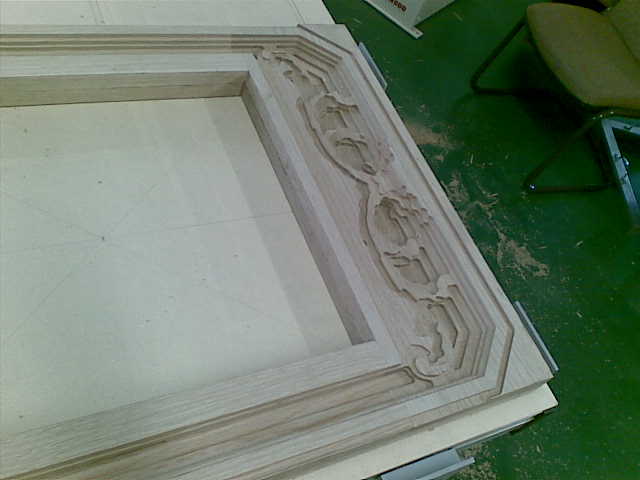

We have a customer interested in a Model C40. we loaded a carving rental program on the machine to do a demo (File - RP-FR-MF0001). we machined the back of the part then did the flip-op. The front of the carving starts of by taking away most of the material with the 0.375" dia end mill cutter, after which it stops retracts about 2" above the material and cuts out the back part again, it shifts down a 1/4" after each pass until it cuts through the material. have you had this problem before on a machine? or can it be because it is a metric machine?

The "SET ZSHIFT=?" is correct, like i stated it has machined the back and the first pass. But instead of picking up the next tool for machining it moves above the board and cuts in the air. The program is about 125 000 lines of code, it gets to about line 11 000 and then jumps back in to a loop which cuts the back. I can not read the code (as you know the thermwood does not allow you to see the program if you are running a CNC rental program or carving)
First pass machining
