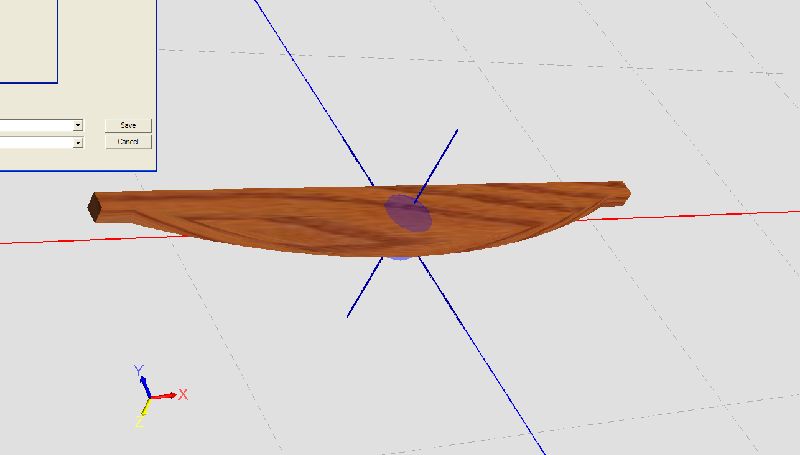

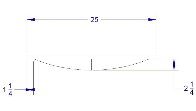

Can anybody tell me how I can create this board?
This is a down view of the board it is going between two cabinets in a bathroom to be the appron for a small vanity area.

Is this what you wanted?
Create a display board 25 x 3, take to part editor, go to contour mode, use the line to trace the straight lines, then the three point arc to draw the arc, go back to part editor, right click and choose create part using closed contour, click the tracing to highlight it green and then click next. Then return saving the changes.
Edit: I forgot to mention, make sure your snap settings are on, I usually have mine set on 1/4" along with the grid settings.
